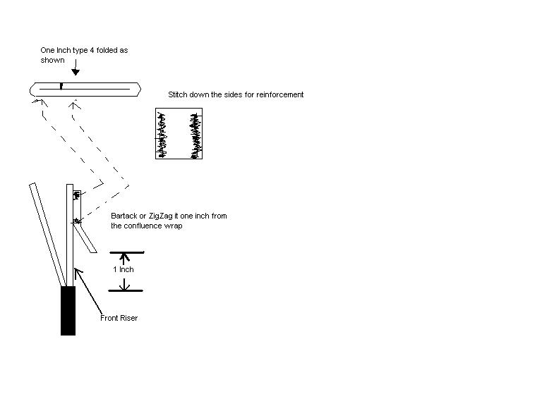

TALONSKY 0 #15 May 2, 2003 For stowing the slider, I have had an extra piece of webbing sewn on the bottom of my front risers about two inchs from the bottom. the webbing is about 1/4 to 3/8" wide and doubled over. It is sewn at an angle may be 30°. So the slider can be pushed past it and then it can not get back up without some help. I like this kind of stow because the slider is not hooked to the pilot and it keeps it all the way down. Kirk Quote Share this post Link to post Share on other sites

masher 1 #21 May 5, 2003 Quote For stowing the slider, I have had an extra piece of webbing sewn on the bottom of my front risers about two inchs from the bottom. I've heard of this before, and it seems like a good idea to me. Would you be able to post some pics of them? Cheers Matthew-- Arching is overrated - Marlies Quote Share this post Link to post Share on other sites
hookitt 1 #22 May 5, 2003 Here's a drawing of the slider catch. I've used this type of catch for many years. It's attached about 1 inch up from the confluence. Credit for to drawing goes to another dz.comer. My grammar sometimes resembles that of magnetic refrigerator poetry... Ghetto Quote Share this post Link to post Share on other sites
masher 1 #23 May 5, 2003 Cool. Thats pretty much what I invisenged (sp?). How do you keep it stuck out to keep the slider down? Do you double the material over to force it out?-- Arching is overrated - Marlies Quote Share this post Link to post Share on other sites
hookitt 1 #24 May 5, 2003 The material is 1 inch type 4 Double it over and Sew a bartack or Tight ZigZag stitch down each side. Then Sew it onto the riser. Heres a quick Diagram My grammar sometimes resembles that of magnetic refrigerator poetry... Ghetto Quote Share this post Link to post Share on other sites
