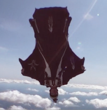

There are two areas in wingsuit flight that laminar flow is ALMOST acheived.
one is in a steep AOA dive there is a point when instead of going exactly on the angle you are pointing you drift more forward(as if you are pulling out of the dive) this is an increase in lift being created (this only works well on a wing with a leading edge shaped better than your arm)
I realize this when I am jumping with Ryan Scarlett who weighs over 300 out the door. when he is flying along he is level with the horizon and I am at a much steeper angle but we are both flying the same path though the sky.
at this AOA there is air flowing over the top of my suit I know this because I can feel the air on the belly of my suit (I am backflying in this example, of course)
The other time I have experienced this is (again while backflying) I fly up underneath someone, both flying at a high forward speed and when I get into an exact spot at an exact speed i get pulled up into them (they are not falling on me)
This is due to air being forced over the top of the wings creating more lift.
This is similar to the ground effect planes get flying close to the ground but not exactly the same.
Basically the air separates farther back along the wing than normal not quite laminar.
So here you go yuri your future wingsuit the "BI"plane cause I heard you swing that way
