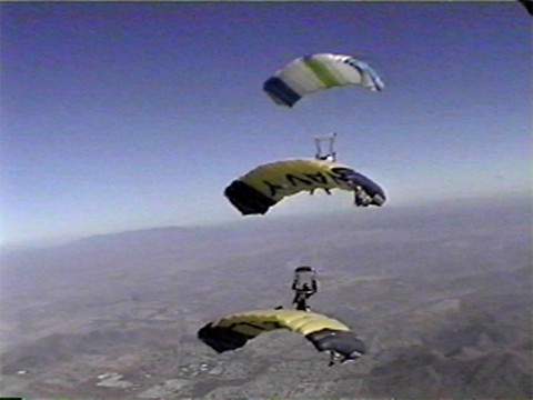

Shark 0 #4 July 17, 2002 Yup, I got a 193, but have never used this particular canopy for crew. Although I use/borrow a 143, your big-ass canopy should be okay for basic stuff like stacks or planes. I've been on a few jumps where we had all sorts of sizes and managed some neat formations. But for Rots & Sequential you will need to be at the same wingloading. Like Wendy mentioned, 1.2 to 1.3. Here's a pic. I'm docked 2nd w/ a L193. The pilot is on a 143 and the guy docked on me has a L193 as well. The rest of the stack ranged from 143s, 160s and a 126. Quote Share this post Link to post Share on other sites
