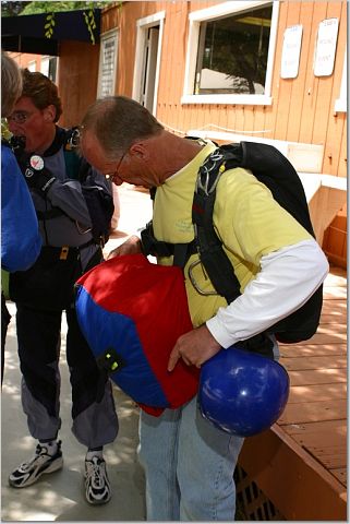

quade 4 #2 May 30, 2003 How large a flag? 1000^2 ft? 2000^2 ft? You might wanna give Jim Wallace a call and see what he recommends. Jim jumps a flag that's a bit over 2000^2 ft and is -quite- impressive. If you go HERE and click on the album of photos, then scroll down to photo 9044, you can see him test jumping a 1000^2 ft flag. Even the 1000^2 ft flag isn't a trivial undertaking so you're doing the right thing by getting as much advice as you can. Tell him I sent you. BTW, you are aware of all the requirements to do demos -- right?quade - The World's Most Boring Skydiver Quote Share this post Link to post Share on other sites

quade 4 #6 May 31, 2003 Quote Finally, remember that guys jumping ginormous flags wear tandem rigs. Not always. Jim Wallace wears a huge bag on the front of his harness that makes it sort of look like a tandem set up, but it's really just a normal rig. The photo shows his bag for the 1000^2 ft flag. The bag for the 2000^2 ft flag is about twice that volume, but if you do the math, that's only maybe 25% larger in all dimensions.quade - The World's Most Boring Skydiver Quote Share this post Link to post Share on other sites
