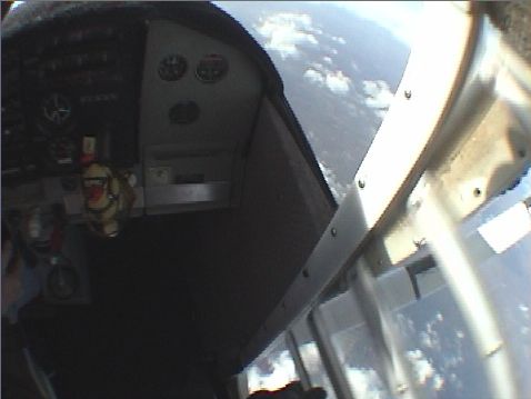

SkymonkeyONE 4 #2 May 15, 2003 I want to see pics of any C-182 with a lexan, roll-up door. I have been jumping a very long time and have never seen anything other than a flip-up inflight door on one. Chuck Quote Share this post Link to post Share on other sites

jerm 0 #15 May 16, 2003 Quote I want to see pics of any C-182 with a lexan, roll-up door. I have been jumping a very long time and have never seen anything other than a flip-up inflight door on one. unfortunately i don't have an external shot of the plane on me (gotta dig out my camera), but here's a show from inside the 182 at Above the Poconos. DYEVOUT : nah, no good shots of the door on the site, but i'll try to dig up a shot and post it later on. Landing without injury is not necessarily evidence that you didn't fuck up... it just means you got away with it this time Quote Share this post Link to post Share on other sites
