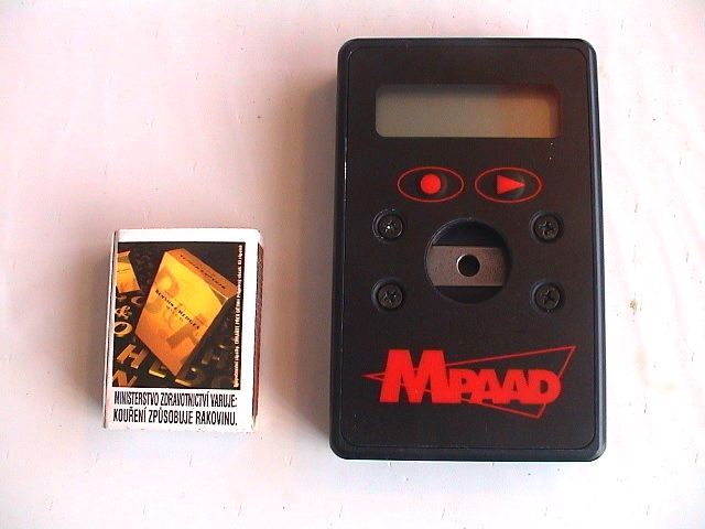

pbla4024 0 #11 April 5, 2003 CYPRES is too expensive and out of date. MPAAD forced Airtec GmbH to do something. They are not used to market competition. There are three test jumpers at our DZ, I could try ask them for their opinios. Enjoy picture of MPAAD. Greetings from Czech republic. Fido Quote Share this post Link to post Share on other sites
JumpHog 0 #12 April 5, 2003 The big problem that I see with the MPAAD is that all of the rig manufaturers will have to modify their rigs in order to use this new AAD. This means cutting another window into the backpad for the MPAAD display, since it doesn't have an external display unit, like the CYPRES. It took many years, for the existing manufacturers to modify their rigs to accept CYPRES', when they hit the market, and that modification was much easier. Also, how many people are going to want to buy a new container in order to use this new AAD. CYPRES' have been proven to be a near-perfect design, and I think any new company will have a hard time competing. I think Airtec had the right idea by updating their CYPRES'. I have been waiting for a while to see when they would come out with a CYPRES II. Over the past 14 years, microprocessor technology and battery technology has improved drastically. Also, add to this the new generation of pond-swoopers, who don't want to ruin their expensive CYPRES when they get wet. I'm hoping to see a waterproof, smaller, lighter, more-compact CYPRES, with a longer battery life, at a lower cost. I guess we'll just have to wait and see. Quote Share this post Link to post Share on other sites
sundevil777 102 #13 April 5, 2003 I also wonder if the unit can be felt (uncomfortable) against your back.People are sick and tired of being told that ordinary and decent people are fed up in this country with being sick and tired. I’m certainly not, and I’m sick and tired of being told that I am Quote Share this post Link to post Share on other sites
BBKid 0 #14 April 5, 2003 The only problem I can see with the mpaad is that some people will be jumping rigs larger than the computer! Jeez that is one big ol' mutha... Nick --------------------------- "I've pierced my foot on a spike!!!" Quote Share this post Link to post Share on other sites

BoobieCootie 0 #18 April 7, 2003 That MPAAD sure looks like an MP3 player don't it Quote Share this post Link to post Share on other sites

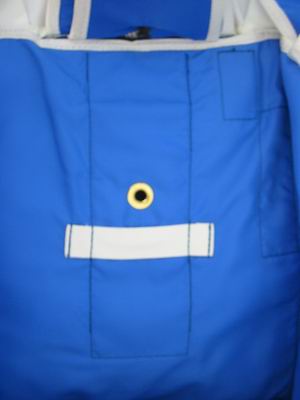

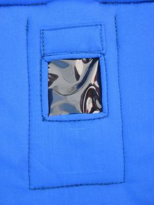

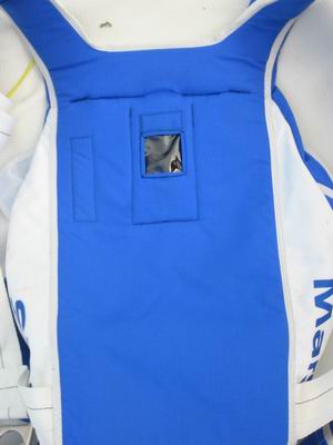

pbla4024 0 #24 April 15, 2003 Rig prepared for MPAAD. Any questions? Fido Quote Share this post Link to post Share on other sites
pchapman 281 #25 April 15, 2003 QuoteRig prepared for MPAAD. Any questions? Yeah - The MPAAD is supposed to have the closing loop fit right through it, and be mounted next to the backpad with a window added. But what about the aluminum plate that's typically in containers to provide a base for the closing loop & cypres washer?? Some can be fairly big, which would make it difficult to orient the MPAAD so one could see whatever controls it has thru a window. Quote Share this post Link to post Share on other sites
