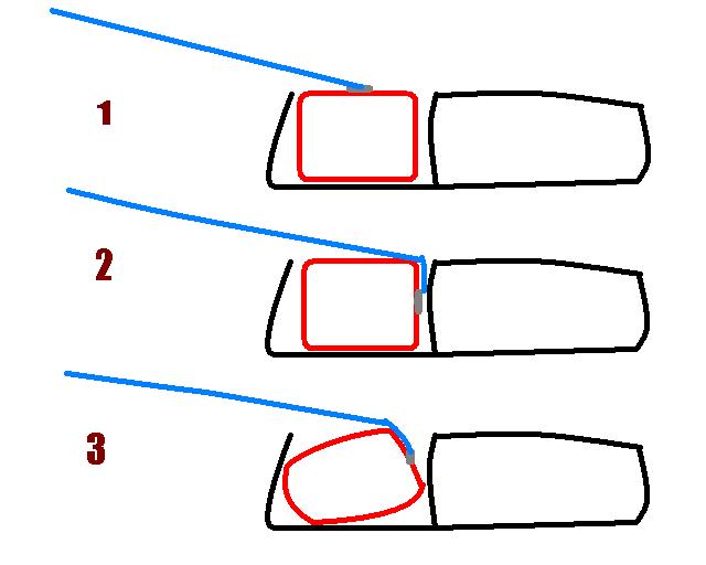

r2hubert 0 #7 April 2, 2003 I understand your point, here is the three different method I have seen. I use to do the number 3 on all my jumps. I guess this is a good compromise between those two methods. I have an old Talon container, I'm not sure the corner problem will be an issue with this container. Thanks for the info I haven't thought about this baglock problem -- Renaud SMA #9 "Mind is like parachute. It only functions when it's open." Quote Share this post Link to post Share on other sites
councilman24 37 #8 April 2, 2003 Three is just a bad job of two. And most bags are dimensioned for 2. But none of these are the problem method of grommet in the bottom. I'm old for my age. Terry Urban D-8631 FAA DPRE Quote Share this post Link to post Share on other sites
