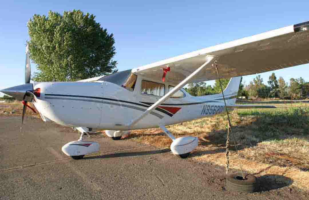

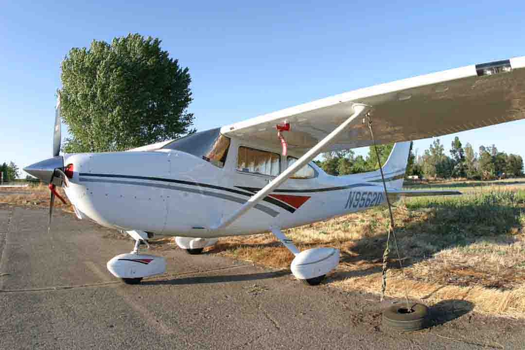

Here you go...
sml968 and sml 971 is the 14, sml969 and sml970 is the 15
Damn' its a pain to get these small enough to upload....
