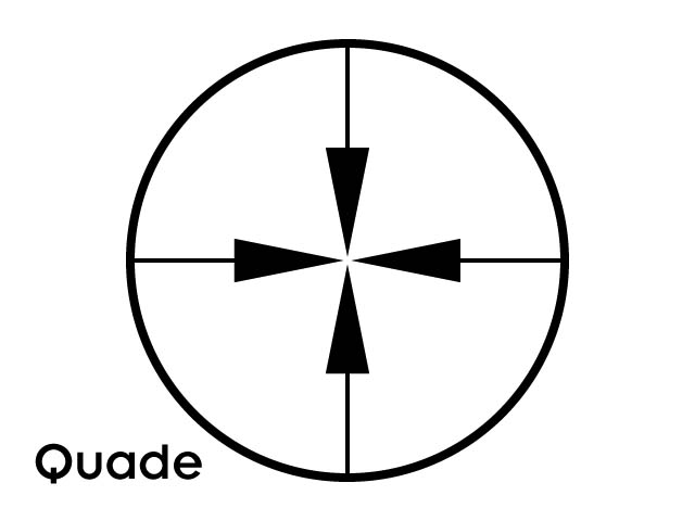

quade 4 #16 June 6, 2003 Ahhh . . . top secret sighting tricks of the stars! Sorry Deuce, I don't think I ever taught you this one. MOST camera flyers I know sight their cameras by wearing them and trusting some other weenie to accurately sight their camera while they're wearing it and adjusting their ringsight. I find this entire process, cumbersome, inaccurate and, in a word, LAME. I've seen camera flyers sighting cameras for other camera flyers sighting their sights and the results are sometimes so bad it would be funny if I wasn't going to be eventually called over to resight the mess. HERE'S the issue. Some people just can't figure out where the center of the viewfinder is. Folks, it's just not that difficult! Just draw imaginary lines from the four corners and that's the middle. I've explained this to people over and over and they still suck at it! As a result, I don't generally use other people to sight or check my sight. I do it all by myself and here's how I do it. I made this little reticule image and saved it to my Memory Stick. Then when I want to sight the camera, I turn it on and super-impose the reticule over the picture by turning on the luminance key. (Read your freekin' manual if you don't know what I'm talking about). Put the reticule on the target and sight the ring-sight with a mirror. Bingo, done. In reality, it's a bit more complicated than that and takes me maybe 15 minutes to get it just about right, but then again, I'm picky.quade - The World's Most Boring Skydiver Quote Share this post Link to post Share on other sites
ltdiver 3 #17 June 7, 2003 QuoteThen when I want to sight the camera, I turn it on and super-impose the reticule over the picture by turning on the luminance key. (Read your freekin' manual if you don't know what I'm talking about). Put the reticule on the target... Your TRV10 taught you that... ltdiver Don't tell me the sky's the limit when there are footprints on the moon Quote Share this post Link to post Share on other sites
quade 4 #18 June 7, 2003 Maybe I taught I taw a puddy tat, but the TRV10 never taught me anything about sighting my camera helmet. I saw the luma key option on the TRV10 and thought to myself, "how can I use this for good instead of evil?" and I came up with the idea myself.quade - The World's Most Boring Skydiver Quote Share this post Link to post Share on other sites

quade 4 #23 June 9, 2003 I love the concept of the laser sights -- I even used to do that a long time ago. The issue is matching them up with the actual center of the TV image and keeping them matched up. Deuce's solution works fairly well, but he (if I understand his previous posts correctly) removes it after it's all been set up, so it's not good as a final boarding check. Gaff taped laser pointers (at least in my experience) are pretty imprecise and the heat of the day usually makes the gaff tape shift around a bit too. As Deuce correctly points out the average laser pointer doesn't have precision adjustments and this is why I eventually ditched the procedure altogether. Lastly, you now have to sight THREE things; camera, sight and laser. Centering any two of which does not nessasarily mean that the third one is also aligned. For example, let's say I'm walking to the plane and decide to do a quick check. I turn on the camera, look through the viewfinder and hit the laser. Yeah, it's in the center of the viewfinder, but does that mean my sight is correct? No. Or, I can put the helmet on and hit the laser and see it's in the center of the sight, does that mean my camera is also aligned? No again. So, ultimately, I have to either trust the gear is aligned correctly to begin with, or bring in a third party to once again look throught the view finder of the camera while I wear the helmet and hit the laser. If all three line up, is it sighted correctly? -- well, again not nessasarily. What if the person looking through the viewfinder doesn't know where the center of the screen is? Back to square one . . . So, anyway, I love the idea of the laser sights, but the reality can still be quite ugly.quade - The World's Most Boring Skydiver Quote Share this post Link to post Share on other sites
Deuce 1 #24 June 9, 2003 Well, the way I check it, and this works super with digital, is to place the ringsite on a target and take a picture with both the SLR and the PC120. I use the top of a tree, or something else that will show a definite point at the center of frame. Check the results and go. Yeah, I leave the weaver base on the D-box, and take the site off when I'm not sighting. Yeah, you have to fine tune it when you put it back on. I don't check center with the laser site, I check it with a photo, or video still. If I get all out of whack (hasn't happened yet) It takes about 5 uninterrupted minutes to get everything back in parallel. Quote Share this post Link to post Share on other sites
