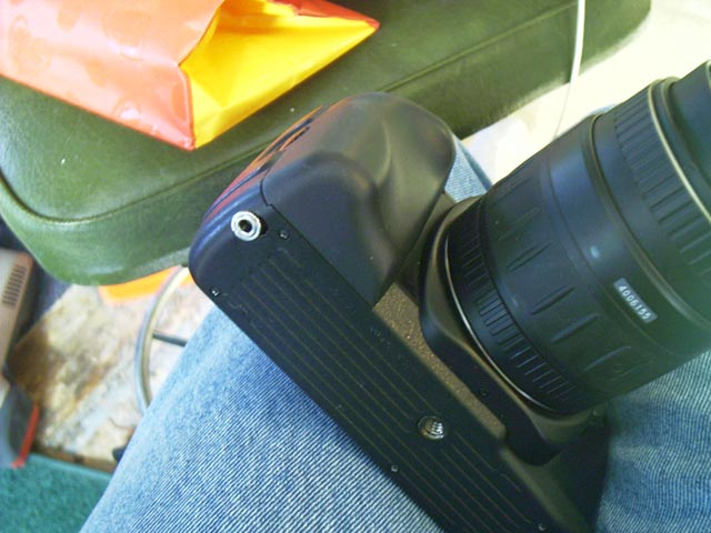

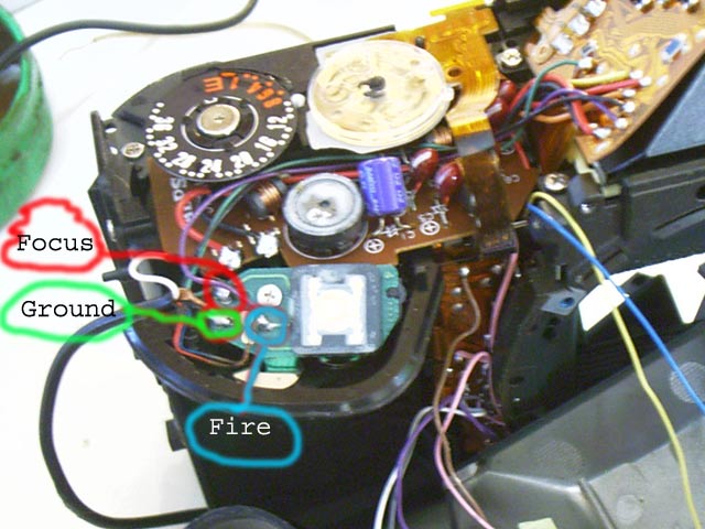

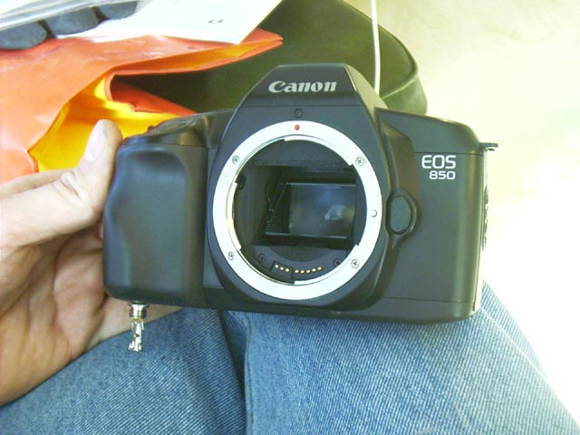

OK, I finished the work on this EOS. It is totally different inside as compared to all the web documents I have found. Basically, it doesn't have the obvious tabs for the remote switch/grip mount, so i had to solder directly to the board the shutter switch is mounted to. It works, and that's all I wanted!
Note: There is very, very little room in this body with the battery and standard grip to mount a jack. I managed to squeeze it in, but it's really tight.
Bottom and front pics show the jack placement, and trust me, on this model, there is noplace else to put it!
Wires pic shows the shutter relase board, and shows which wires are for which function.
Sorry, I used the wrong colors to highlight, but these are the color of the wires on the board:
Black=Ground-signal return
Green=Focus
Purple=Shutter fire
Of course, to use all these you need a 2 stage switch, but when shooting in manual focus, you only need to fire. Here's the catch:
When in either mode, BOTH the green and the purple wires must be grounded to black to fire the shutter. Groundng just the green focuses the lense (if auto focus is turned on), while grounding just the purple does nothing. Grounding both in AF causes the camera to focus before firing, and grounding both in Manual mode causes instant firing of the shutter.
Easy to set up when you wire in a switch, I think.
