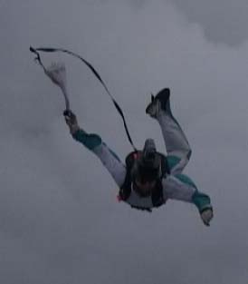

freekflyguy 0 #1 January 10, 2003 When I first started jumping my camera suit I found pull time quite disconcerting, I felt as if I was going to go unstable because of the uncollapsed wing. After a while I didn't think about it and just pulled stable no probs. Whilst filming a fun jump in spain on our staff trip, I asked one of the guys to film me dumping out. Whilst I was editing the end of year video, I noticed that on pull as I move my arms I drop my right knee. This is something that I was not aware i was doing. What do you guys do?It's nice to be important, but it's more important to be nice. Quote Share this post Link to post Share on other sites
Deuce 1 #2 January 10, 2003 I do a full extension to slow down as much as I can, then put my feet up as I bring both arms in to my sides and pull. Yeah, it takes some getting used to, doesn't it? Cause if you stay in a boxman and you reach back with your right arm to pull, that left wing will flip you over. If you leave your legs out and collapse both wings, you end up head down. And if you get nice and stable with your feet on your butt and your elbows in, you're hauling ass when you deploy. Fun, though, huh? Have you made the mistake of hauling down to a formation and going to pop the wings only to realize you're in your RW suit? Vrooom. Quote Share this post Link to post Share on other sites
skydog 2 #3 January 10, 2003 Do you mean like this............. Freaked me out when I first saw the video. Strangely only happens when flying the camera suit. Also, I do not get deployment problems. (video shows recovery back to a symetrical position as the bag lifts off my back.......) Bryn Quote Share this post Link to post Share on other sites
diablopilot 2 #4 January 10, 2003 1) Full extention -get everything out there to slow down...especialy important if I've just been on my back filming an tandem opening. 2) Left arm comes in like the Mantis position, right arm back to pull. Right leg/knee digs in (drops), left leg raises slightly. 3) P/C Released and everything straightens out, start flying the deployment, hands on risers. works for me.---------------------------------------------- You're not as good as you think you are. Seriously. Quote Share this post Link to post Share on other sites
quade 4 #5 January 10, 2003 I think I've finally crossed over into some weird area where I honestly have no exact idea what I'm doing as I'm tossing out. I -believe- I'm pulling my left arm forward just like a normal belly flyer would, but I honestly can't say for certain if that isn't being offset by some funky leg position or body twist. All I think about is maintaining heading and driving forward just slightly. I -believe- that by driving forward just slightly (just a couple of feet), it keeps the pilot chute out of the burble behind me and I -believe- I get better openings. But honestly, after about 1,000 camera jumps, I can't say I have a clue. I'm just not thinking about it all that much any more.quade - The World's Most Boring Skydiver Quote Share this post Link to post Share on other sites

freekflyguy 0 #9 January 10, 2003 QuoteDo you mean like this............. Yup, just like that. Buzz not Tommy CooperIt's nice to be important, but it's more important to be nice. Quote Share this post Link to post Share on other sites

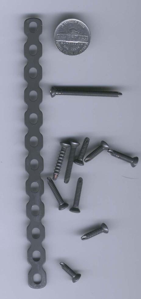

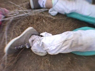

freekflyguy 0 #10 January 10, 2003 Quote freakflyguy, what is your profile photo? its been bugging me for days now, just cant work it out. Its the result of trying to flare with fingers still in dive loops.I've attached some better pics, Vans off is the profiole pic. BuzzIt's nice to be important, but it's more important to be nice. Quote Share this post Link to post Share on other sites

freekflyguy 0 #16 January 10, 2003 Quote Oh, ugh. Never get in serious trouble around a vidiot. They'll get great footage of you getting mauled by a bear and forget to helpCongratulations on your recovery (I'm hoping you recovered...) No one got my impact on video, but I told the first person on the scene (Mick Nealis) to go get it camera and video the rest. I had the accident in Nov 01, was off the road till Apr 02, had the metal work out a year to the day after it was put in. So I didnt miss much of the season, and still managed 300 jumps last year. BuzzIt's nice to be important, but it's more important to be nice. Quote Share this post Link to post Share on other sites
