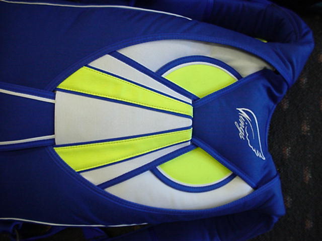

flyingferret 0 #72 March 11, 2003 Dude, when do you get yours? I got mine on Friday and it is so freaking pimp, I love it!!!-- All the flaming and trolls of wreck dot with a pretty GUI. Quote Share this post Link to post Share on other sites
skygod7777 0 #73 March 11, 2003 QuoteDude, when do you get yours? I got mine on Friday and it is so freaking pimp, I love it!!! pics?? later Quote Share this post Link to post Share on other sites
flyingferret 0 #74 March 12, 2003 Will post when I can, it is getting assembled. Here is one before I had options added -- All the flaming and trolls of wreck dot with a pretty GUI. Quote Share this post Link to post Share on other sites
