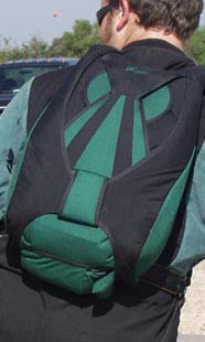

freeflyz 0 #23 February 7, 2003 this is a pic of the Mirage G3 FF handle Quote Share this post Link to post Share on other sites
AggieDave 6 #24 February 7, 2003 Heres a (really bad) pic of the Wings FF handle. --"When I die, may I be surrounded by scattered chrome and burning gasoline." Quote Share this post Link to post Share on other sites
Staso 0 #25 February 12, 2003 QuoteHeres a (really bad) pic of the Wings FF handle. why does is stick out so much ? and the same on the previous picture post. i have odyssey and the handle lays flat on the bottom of container. it seems that this way it would be more secure. i plan to go even further to secure it - i wanna attach velcro on the flat piece of the handle and BOC, right on the edge of the pouch. not that i think that it's not secure enough, i'm just afraid that premature deployment in speed skydiving mostly is fatal. stan. -- it's not about defying gravity; it's how hard you can abuse it. speed skydiving it is ... Speed Skydiving Forum Quote Share this post Link to post Share on other sites
