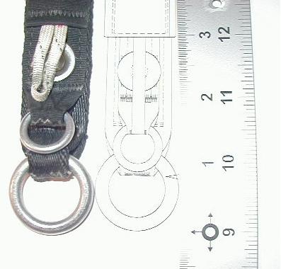

Hooknswoop 19 #1 February 3, 2003 How many problems with this old 3-ring can you find? Hook Quote Share this post Link to post Share on other sites

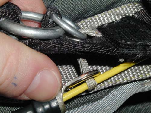

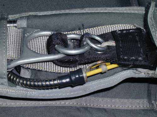

fudd 0 #2 February 3, 2003 Took me some time, but the loop line comes out side by side and not on top of each other like in the sketch. I'm I right? Can't find any more, at least for now. What are the dangers with this except not beeing done according to specs? I posted a picture of my three rings for comparisons...(please tell me if you find any problems with my three rings, cause they should be ok and I will be jumping with it...) There are only 10 types of people in the world. Those who understand binary, and those who don't. Quote Share this post Link to post Share on other sites
AggieDave 6 #3 February 3, 2003 That and the probably wouldn't have released correctly, appearing to have not had their normal monthly maintance done (flexing the riser/ring assembly).--"When I die, may I be surrounded by scattered chrome and burning gasoline." Quote Share this post Link to post Share on other sites
Kris 0 #4 February 3, 2003 The overlap on the locking loop and the overlap on the rings are way off. The tension would be very high on the loop and the top ring. KrisSky, Muff Bro, Rodriguez Bro, and Bastion of Purity and Innocence!™ Quote Share this post Link to post Share on other sites

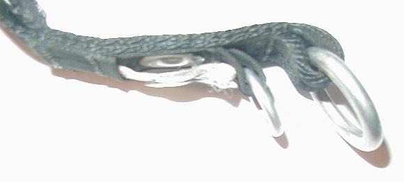

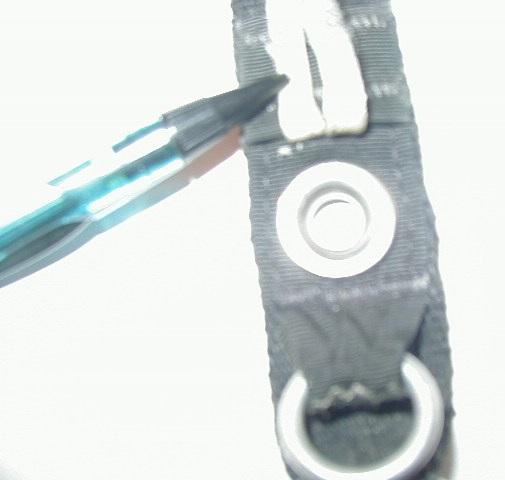

Hooknswoop 19 #5 February 3, 2003 Close to 200 views and only 3 responses? What's wrong: 1) The white locking loop is too short and is frawed from the a sharp edge on the grommet. 2) The material for the small ring is 1 inch type III (525 lbs), it is supposed to be 5/8 inch square weave type IV (625 lbs). 3) The small ring is set to far away from the medium ring. 4) There isn't any confluence wrap 5) There isn't any re-inforcement tape (type III) between the type XVII riser webbing They are inefficent and weak. The riser is one of the first early mini-risers built. It is hard to see all of this from the pics. Hook Quote Share this post Link to post Share on other sites
PhreeZone 20 #6 February 3, 2003 The only pic I could really see clear was the third one.Yesterday is history And tomorrow is a mystery Parachutemanuals.com Quote Share this post Link to post Share on other sites
