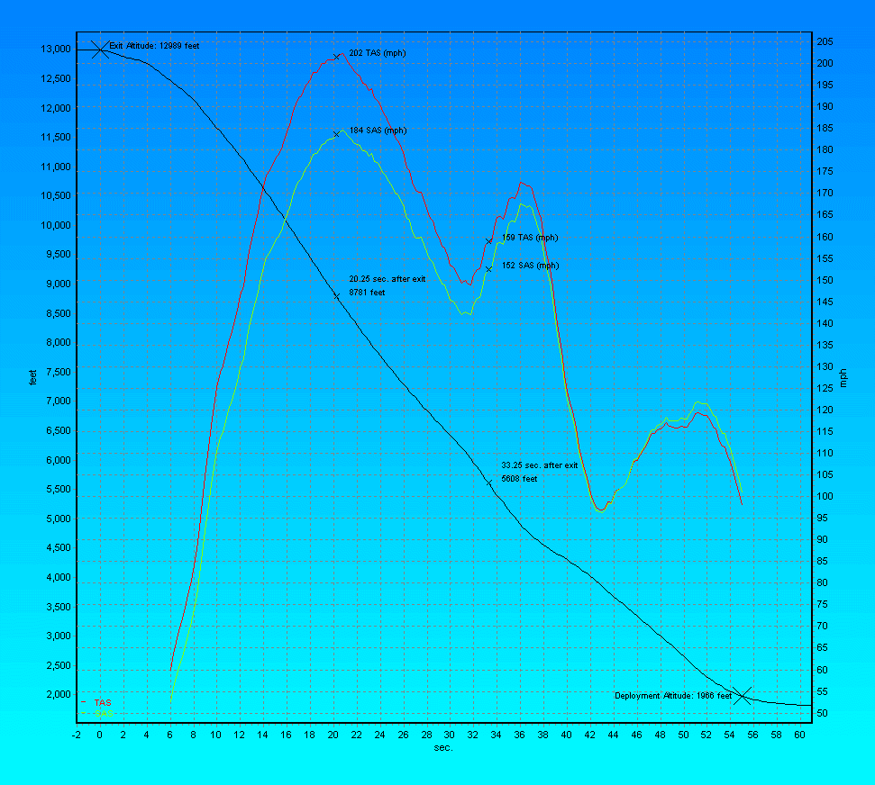

Staso 0 #12 December 2, 2002 QuoteWhat gives? Anyone know how 170mph would come up, or does the protrack give a vector speed including horizontal movement somehow? My Pro-track is set for SS. Thanks for any info about it. Just curious if this is a bug or something. change SAS to TAS and see how much it show. what was the average speed for the dive ? average for the first and second half ? stan. -- it's not about defying gravity; it's how hard you can abuse it. speed skydiving it is ... Speed Skydiving Forum Quote Share this post Link to post Share on other sites
Sonic 0 #13 December 2, 2002 Changing it to TAS should only increase the speed----------------------------------- It's like something out of that twilighty show about that zone Quote Share this post Link to post Share on other sites
Staso 0 #14 December 2, 2002 Quote Changing it to TAS should only increase the speed i just checked some graphs and it's basically true. to some altitude (don't remember the exact number) SAS will be lower. and it will be higher after that. see pic attached. stan. -- it's not about defying gravity; it's how hard you can abuse it. speed skydiving it is ... Speed Skydiving Forum Quote Share this post Link to post Share on other sites
Sonic 0 #15 December 2, 2002 Should be 4000 feet, cos that's what it's calibrated to.----------------------------------- It's like something out of that twilighty show about that zone Quote Share this post Link to post Share on other sites
Staso 0 #16 December 2, 2002 QuoteShould be 4000 feet, cos that's what it's calibrated to. yeah, i think it's 4000 ft. it looks more like 3500 on the picture but it just means that temperature and preasure were not standard at the time. stan. -- it's not about defying gravity; it's how hard you can abuse it. speed skydiving it is ... Speed Skydiving Forum Quote Share this post Link to post Share on other sites
