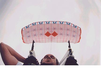

PhreeZone 20 #29 December 21, 2002 Where are you applying compression at on a canopy? Unless you have someone standing on your canopy all the forces should be suspended. The way I understand it, the most efficient angle for a crossbrace should be the angle of the weight transfer from the line attchment point to the top skin with out any bracing present. Normally ribs (specifically load bearing ribs) take the majority of the stress and from there transfer across the top skin the forces until they run into forces acting in the oppsite direction. Non load bearing ribs take the rest of the weight transfer since they are where two forces from the top skin meet, the bottom skin recieves only enouigh force to keep skin tension. You can apply and alter additional forces by the addition of design considerations such as braces or airlocks. Braces apply the forces directly along the angle of the brace, you don't need it to be the strongest possible angle, just the angle that transfers the forces to points on the canopy that it proves to be most benificial. If your able to adjust the location of the weight transfer to the middle of the cell instead of the non weight bearign rib you are able to make a cleaner airfoil by altering skin tension in smaller incriments. Look at the amount of wrinkles on the top skin of a Raven in flight, then look at a Saber, an FX has less and since the skin is even better controlled on a VX it has less distortions thne even an FX. Even an Airlock canopy has a tightly controled area that has only tiny wrinkles(right across the airlocks) and the rest of the canopy has the normal distortion. A 33 cell would be the next logical move from Icarus. 11 cell planforms were tried and used with some success in the past. With the higher aspect ratio of the Onyx over a VX there are bound to be some major design differences. The BASE community has done some really cool projects such as cameras in canopies with streamers and markers used to show the wind flow patterns and the application directions of load forces that different canopy design changes have on a canopy.Yesterday is history And tomorrow is a mystery Parachutemanuals.com Quote Share this post Link to post Share on other sites

sdctlc 0 #31 December 21, 2002 The point made is along the lines of my first impression, nothing to do with the quality of the Cobalt line or the company but more the construction of the canopy. I pulled up pictures of the Cobalt and the now accepted "traditional" Tri cell design using the Xaos-27 pics as a comparison. It seems to me that the canopy though having 36 cell when looking at the view from the top, is in acctuality a 9 cell with more internal support. Looking closely at the pictures and thinking in terms of the canopy as a 9-cell design, each half of an individual cell has approx 1/3 segrated with a support or cross brace. This seems to result in making the topskin smoother. Therotically this should improve the airflow and in turn increase lift. My opinion is that it is not a 36 cell in the sense of what is/has been recently considered the multicell or "tri" cell design, meaning a cell with a decernable rib and in some cases an associated cross brace. That said just because it may not jive with the above referenced current notion of a multicell canopy in "tri cell" construction lets not bash right off the bat and say its not in line with what we think it should be. If the innovation of the smother topskin creates an improvement in performance call it what you want (supported 9-cell, quad cell, whatever) and enjoy the performance improvement. My first thought was thats not a 36 cell canopy, but after thinking about it, even though it might not be, it looks like they are trying to think "out of the box". Gotta love innovation, good and bad! The discussion should be less the semantics describing the construction but more towards the gains if any in the design performance. If it turns out to work and is better regarding a performance improvement, every body will tri to follow the design in some fashion and all of the swoop loving jumpers will shell out a ton of money to have the canopy. If not it will fade away like previous innovative designes, couple of examples of this are the AR-11 and the Evolution. Scott C."He who Hesitates Shall Inherit the Earth!" Quote Share this post Link to post Share on other sites
cobaltdan 0 #32 December 21, 2002 as per a previous thread '# of cells' as pertains to a cross braced canopies is being defined as the number of divisions formed on the top skin between line attachment points. i.e. fx/velocity = 3*7= 21 , vx 3*9=28, onyx 4*9=36. aerodynamically reducing spanwise distortion on the bottom skin translates into no improvement of efficiency. so according to our design philosophy why then add the extra vertical ribs to create a quad cell or for that matter even a tri cell with reguards to the bottom skin. no reason except increasing pack volume.... additionally your logic with reguards to the cross braced angle is incorrect. this is a tension structure. maximum force is transfered through a rib to the line when it is vertical. as a rib is slanted it progressively carries less and less tension. result on the onyx is an aifoil which is significantly lower in distortion than the vx, but with a 1/3 lower pack volume. additionaly the nose remains fully rounded in high speed flight and does not blunt or dimple in as does every other canopy ever designed. this further adds to the wings efficiency. 'odd design' thank you i will take that as a compliment. 'couple of years behind state the art'. curious as to why you think that? while everyone else was creating cross bracing canopies based on the stilletto. we were busy perfecting the 9 cell before releasing a cross brace based in it. the cobalt is the only 9 cell canopy that is competitive against what i guess you are calling state of the art. a comp cobalt ranked 2nd out of a field of 160 cross braced canopies after a full year of pro competition in distance and speed. we have 13 patents pending, and have set more records in the last two years than i can count, and were competitively chosen over all other parachute companies to develop the next best ram airs for the us military. i think we are doing a good job of being 10 years ahead. sincerely, dan<><>Daniel Preston <><> atairaerodynamics.com (sport) atairaerospace.com (military) Quote Share this post Link to post Share on other sites
cobaltdan 0 #33 December 21, 2002 high aspect ratio: we have built prototype canopies up to 3.4. and are playing with a design at 5.0 (military not swooping). but we are finding that a higher aspect ratio canopy will give you higher efficiency at slower speeds but not at higher speeds. imo the ultimate swoop machine meaning longest swoop will probably have to remain a canopy below approximately 3.0 ar. and simply be very fast. increasing speed over ar will make more difference. sincerely, dan<><>Daniel Preston <><> atairaerodynamics.com (sport) atairaerospace.com (military) Quote Share this post Link to post Share on other sites

cobaltdan 0 #36 December 21, 2002 kirk, the cross brace seams are i beams not roll seams. the over all design induces a cumulative error less than a tri-cell design. and as explained the cross braces transfer more force the closer to vertical they are. sincerely, dan<><>Daniel Preston <><> atairaerodynamics.com (sport) atairaerospace.com (military) Quote Share this post Link to post Share on other sites

TomAiello 26 #45 December 26, 2002 QuoteA canopy that can fly backwards or forwards would be innovative No, it would be pretty darn close to the holy grail. 180? No problem, just fly backward. There's been some good theoretical designs, but no one has had the wherewithal to actually try building one yet. Get one of those built, and I'll worship you. Plus, you'll save a lot of lives.-- Tom Aiello Tom@SnakeRiverBASE.com SnakeRiverBASE.com Quote Share this post Link to post Share on other sites
rhino 0 #46 December 26, 2002 That is one nice looking canopy..... Quote Share this post Link to post Share on other sites

DutchSkyCam 0 #48 December 27, 2002 I'm not an expert, but too many people are just guessing around... Please don't draw conclusions until you have read the whole message. a 7 cell has 8 line groups (you know what I mean) a 9 cell has 10 line groups (a 21 cel has line groups (8) a 27 cell has line groups (10) The Onyx has 10 line groups (which makes it a 9 cell)... The way cells are counted (nowadays) has nothing to to with the amount of (classic) cells... It has to do with the way the fabric of the topskin (and indirectly the bottomskin) is/are controlled and the way the cells are locked in place (braced - as explained on the icarus website)... In normal (conventional) parachutes cells are devided in two, a non-loadbearing rib in the middle to support the structure. In an X-braced parachute (FX, VX, Velocity) cells are devided in three sections, off which the outer two are X-braced. This is to reduce bulge distortion, to keep the upper surface flatter. Since the cell is devided in three and the bottom surface is supported by the non-loadbearing ribs (that the X-braces connect to), the bottom surface will be flatter as well. In the Onyx the cells are divided in two sections, the bracing braces from the line attachment point to halfway the top skin of the section. Since it doesn't brace directly to a non-loadbearing rib, it does not affect the bottom-skin as good a the others. (I can even emagine you get a lot of strange forces through your canopy) Sumary... Theoretical comparrison, the way I understand it. Topskin bracing: Top skin of an FX looks like a 21 cell parachute (7x3) Top skin of a VX looks like a 27 cell parachute (9x3) Top skin of a Onyx looks like a 36 cell parachute (9x4) Bottomskin bracing: On the FX, VX and Velocity the bottom skin is (indirectly) braced by the non-loadbearing rib the X-Brace connects to. Since the X-Brace on the Onyx does not directly connect to a non-loadbearing rib, the bottom skin (see photos on message 1) is (less effectively) braced by the non-loadbearing ribs... Bottom skin of an FX looks like a 21 cell parachute. Bottom skin of an VX looks like a 27 cell parachute. Bottom skin of an Onyx looks less than an 18 an cell parachute. Bracing (interlocking): With bracing -in this aspect- I mean the abillity to keep the parachute in shape, even in turbulence... Hard to compare the bracing capabilities... (I'm not an expert) Since the braces are load bearing, i would say: 'Depends on wingload(vertical pull) and the forces trying to pull the canopy out of shape (horizontal pull) and the angle of the bracing'... Wanted: I have 500+ jumps on an FX 104 @ 2.1 loading... The top skin tore near the bridal-attachment... one of the X-braces came off... need a reline... ($$$) I Need a new parachute... (I think I know what I want $$$$$) Can I test the Onyx??? (before I buy something else?) Barry... Quote Share this post Link to post Share on other sites
IMGR2 0 #49 December 27, 2002 This information you have come up with is quite helpful. I would be very interested where you gathered it from. [In the Onyx the cells are divided in two sections, the bracing braces from the line attachment point to halfway the top skin of the section. Since it doesn't brace directly to a non-loadbearing rib, it does not affect the bottom-skin as good a the others. (I can even emagine you get a lot of strange forces through your canopy)] I can only assume this is your opinion seeing as though you have never seen an Onyx fly with your own eyes. It seems to me that your post is quite bias towards the Icarus canopies with no supporting data. I believe canopies are like cars. They all get you to where you want to go. Some people like fords, chevys and toyotas. This IS a new design, when they come out to the public take it for a test drive then make your assumptions. One thing I can guarantee is the pack volume. Can't give you exact numbers but the VX 79 and the Onyx 95 packed up in my Voodoo VOO just about the same. Do not take this as a flame of sorts, just don't like to see people post negatively about something they have never seen or used. Bryan Quote Share this post Link to post Share on other sites
