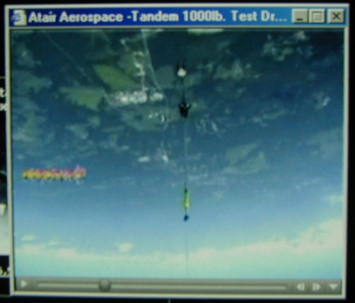

Hooknswoop 19 #26 December 18, 2002 Quote i am saying that i have video and sensor data logged showing a 29g's at line stretch with canopy completely in the bag. After watching the clip, the large jump in the graph occurs after the canopy leaves the bag. Looks like an awefully large PC too. Looks large enough to be considered a drogue. Edited to add the pic. Hook Quote Share this post Link to post Share on other sites

Hooknswoop 19 #35 December 27, 2002 Dan- Could you reply to my post, the one w/ the pic attached?, http://www.dropzone.com/cgi-bin/forum/gforum.cgi?do=post_view_flat;post=314679;page=2;sb=post_latest_reply;so=ASC;mh=25; Thanks Hook Quote Share this post Link to post Share on other sites
cobaltdan 0 #36 December 27, 2002 hi hook, i did respond. go back in the thread and you will notice i said it was a military tandem drop. 1000# exit weight, 350 sq' main, vector tandem rig, 184mph speed at deployment. scrunchie failed to collapse drogue, line stretch generated 29g's, canopy upon exiting bag generated a max of 6.4 g's stage 1, about 3.5 g's stage 2. sincerely, dan<><>Daniel Preston <><> atairaerodynamics.com (sport) atairaerospace.com (military) Quote Share this post Link to post Share on other sites
Hooknswoop 19 #37 December 27, 2002 I mean the post with the pic. The pic clearly shows the canopy out of the bag and the "G" graph hasn't hit a peak. You said: Quotei am saying that i have video and sensor data logged showing a 29g's at line stretch with canopy completely in the bag. the peak width is 4 miliseconds. then a completely new peak of 6.4 g's when the canopy exits the bag and catches air (6.4 stage 1, droping to 3.5g's stage 2, width 5 seconds). But this isn't consistant with the video. Just looking for clarification. Is the graph not quite in synch with the video? Hook Quote Share this post Link to post Share on other sites
cobaltdan 0 #38 December 27, 2002 hook, it has hit a peak. it is just a very fine line (peak rise time is 2 miliseconds) and doesn't show well on the compressed mini format video posted. you can distinctly view the peak on the original dv or by comparing time code to data logged. sincerely, dan<><>Daniel Preston <><> atairaerodynamics.com (sport) atairaerospace.com (military) Quote Share this post Link to post Share on other sites
Hooknswoop 19 #39 December 27, 2002 OK, that explains it, thanks. Hook Quote Share this post Link to post Share on other sites
