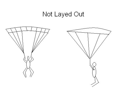

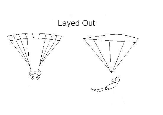

christopherm 0 #22 November 23, 2002 These aren't that great of pictures but i tried my best to illustrate that surface area can be taken away by leaning forward and therefore reducing drag and also that you can make your body more aerodynamic. They are a bit exagerated but hopefully you get the point. It might not necissarily double the length of your swoop but will definately help. -So, how hard is the ground?! Quote Share this post Link to post Share on other sites
Scoby 0 #23 November 23, 2002 Er, isn't that leaning backwards? Certainly, any significant reduction in frontal area is going to have a non-trivial effect on total drag, as long as the coefficient of drag isn't raised by the change. Anyway, I can't comment on how that would affect a swoop because I'm a long, long way away from having any sort of relevant experience. Quote Share this post Link to post Share on other sites
Hooknswoop 19 #24 November 23, 2002 Quote Er, isn't that leaning backwards? Only if the canopy is hooked up backwards.Hook Quote Share this post Link to post Share on other sites
Scoby 0 #25 November 25, 2002 Quote Only if the canopy is hooked up backwards. Doh, misread the drawing somehow... Quote Share this post Link to post Share on other sites
