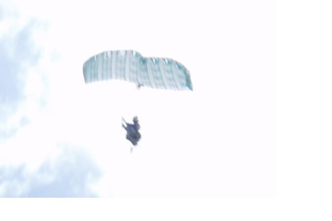

rgoper 0 #4 July 10, 2002 see attached .jpeg of derek's (hooknswoop) canopy after a 180 snap, and and front riser grab, i'm assuming by his body position he's shifting weight in the harness to get more or faster response from the canopy. i've seen hook do this many. many times over the years, and i never noticed the distortion in the VX-60 X-braced canopy he's flying here. he's been clocked with a radar gun at SDSL at 98 MPH, if my memory serves me correctly, and i'm sure it does. i was surprised to see the shape of this canopy when i viewed this .jpeg the first time. i could be wrong about what he was doing, when he was doing it, i'm sure he'll correct me, he's a hell of a swoopmonster! see attached.--Richard-- "We Will Not Be Shaken By Thugs, And Terroist" Quote Share this post Link to post Share on other sites

eames 0 #6 July 11, 2002 The shape of his canopy in that picture has nothing to do with crossbraces or airlocks or their characteristics. That will happen to any canopy when one quickly pulls a front riser significantly farther than the other front riser (snap hook). You just don't see so many people doing that anymore. Jason Quote Share this post Link to post Share on other sites
freeflyguy 0 #7 July 11, 2002 It looks to me like Hook is grabbing a large handful of front riser in that picture too. It is distortion, but not the kind of distortion a x-braced is better at. What a x-braced has over a non is like this. Think of a bread sack that measures 12 inches long when laid flat, no air. Then blow air into it. Although it is technically the same lentgth, it will now only measure say, 10 inches. What the x-braces do, is maintain that length. So a x-braced breadsack would measure 11 inches, with air and a non braced, stilleto or airlocked would measure 10. In effect a 120sf x braced will have more useable square foot over your head when inflated, then a non braced 120. I think I will get a sandwhich. j ---------------------------- bzzzz Quote Share this post Link to post Share on other sites
