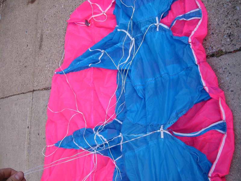

cobaltdan 0 #41 September 20, 2002 greg yarbonet is alive, well and works part time for atair aerospace. he is an amazingly nice guy ! (he did not die in any accident) attached is a pic of the V-wing canopy greg and i designed last year. this one is a 95. double skin nose which transitions to a single skin behind the b lines. V shaped ribs form airbeams extending to the tail. the resulting high chamber airfoil have very low volume. it was an experiment to gauge using high chamber wings for base canopies. the canopy was very slow in foward speed and very floaty. flys more like a 200 than a 95... sincerely, dan<><>Daniel Preston <><> atairaerodynamics.com (sport) atairaerospace.com (military) Quote Share this post Link to post Share on other sites
PhreeZone 20 #42 September 20, 2002 Psst... no attachment Dan Yesterday is history And tomorrow is a mystery Parachutemanuals.com Quote Share this post Link to post Share on other sites
JohanW 0 #43 September 21, 2002 Quotethe resulting high chamber airfoil has very low volume. it was an experiment to gauge using high chamber wings for base canopies. the canopy was very slow in forward speed and very floaty. flies more like a 200 than a 95... High chamber or high camber? If indeed high chamber, what does that mean?Johan. I am. I think. Quote Share this post Link to post Share on other sites
howardwhite 6 #44 September 21, 2002 "greg yarbonet is alive, well and works part time for atair aerospace. " I'm delighted to hear that, and sorry to be wrong. I wonder who I was thinking of. HW Quote Share this post Link to post Share on other sites
cobaltdan 0 #45 September 21, 2002 i think the attachment will work this time... i know....i can't spell...i will try to post some airfoil pictures this week when i am in the office for explanation. sincerely, dan<><>Daniel Preston <><> atairaerodynamics.com (sport) atairaerospace.com (military) Quote Share this post Link to post Share on other sites
