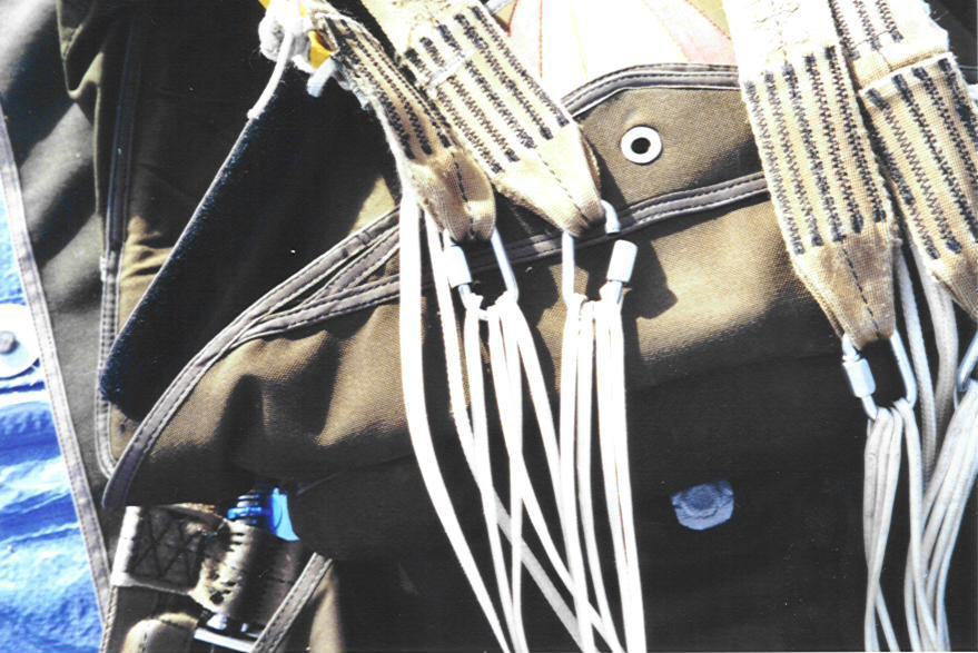

JohnRich 4 #1 September 6, 2002 Attached is a picture which shocked the heck out of me one day while packing. See anything odd? Yeah, check out that connector link. I didn't notice that under canopy, and only saw it when completing the next pack job while stowing the risers. Yikes! Check your nuts! Quote Share this post Link to post Share on other sites
JohnRich 4 #2 September 6, 2002 Well, there was supposed to be a picture attached, which somehow didn't make it into the message. Let's try again... Quote Share this post Link to post Share on other sites

ernokaikkonen 0 #4 September 6, 2002 Whoa. Glad you're ok! A couple of things popped in my mind: 1) The next link to the right seems to be loose too. Were these properly installed in the first place? By a rigger? 2) There are no plastic/rubber/silicone covers on the connectors. This will cause premature wear on the slider grommets, which in turn will wear out your lines. I recommend that you have slider bumpers installed. 3) A question to the riggers out there: Could something like this happen with soft-links(provided of course that they are properly installed in the first place)? I understand that the tightness of the nuts on the connector links should be checked periodically. Is there something similar with softlinks, or are they basically maintenance-free? Erno Quote Share this post Link to post Share on other sites

Hooknswoop 19 #9 September 6, 2002 Rapide links should be loc-tited and marked to show if they begin to turn. They should be checked periodically (during the 30- day 3-ring maintenance is a good time) to make sure they are still tight. Links should also have some sort of slider bumpers, cloth or silicone, like someone already mentioned. Soft links don't require any maintenace, but should also be checked perriodically(again, the 30-day 3-ring maintenance is a great time). If you have switched from links to Slinks, be sure your slider groments doesn have any sharp edges (caused by the slider groments hitting the links w/o bumpers). Colapsing and pulling your slider down will save wear and tear on your lines, bumpers and links/Slinks. The slider flapping, even if colapsed, beats the groments against your lines/bumpers/links/slinks, causing wear. Hook Hook Quote Share this post Link to post Share on other sites
JohnRich 4 #10 September 6, 2002 You hit all the big points there. I'll elaborate for others. Loc-tite is a product used by mechanics. It's a fluid that comes in a little tube - you dribble some on your threads, and then screw on the nut, and it "glues" the nut in place so it won't back out. Get the medium strength variety, that won't permanently affix the nut. You do want to be able to remove it some day. You just want to assure that the nut doesn't back itself out from the repeated vibration of opening shock. Likewise, having tubing over the link helps hold the nut in place so it can't turn. This is another benefit of tubing, in addition to keeping the slider grommet from getting nicked up, and fraying your lines. You can use something like red nail polish to paint a line on the nut and the adjoining link. That way if the nut does start moving, you know it immediately with a quick visual glance, because the marks will no longer be lined up. And don't get paranoid and overtighten the link nuts either, as you can strip the threads or crack the nut. They should be tight, but not muscled tight with a great deal of force. Quote Share this post Link to post Share on other sites
