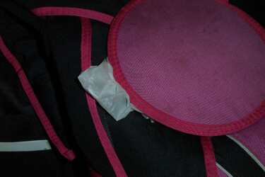

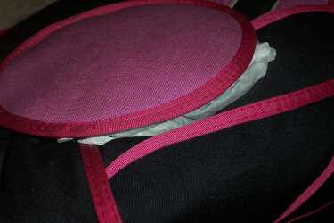

pilotdave 0 #1 August 6, 2002 After getting my reserve repacked, the reserve pilot chute started coming out from the spring after jumping. I had the rigger stuff it back in and tighten the pop top down, but it came out again after each jump. I tried stuffing it into the spring before a jump yesterday, but between putting the rig on and getting into the plane, it came back out. I ended up getting kicked off the plane because it didn't look right (which is good... I don't want to jump it like that. The rigger suggested I keep stuffing it back in there and try to massage the reserve a bit to fill the gap under the pop top so it can't come back out. But, thats what I tried before and it didn't seem to work. He said the pop top is tighted down as much as he could get it. He's off to rantoul now, but he said when he get's back he'll call...umm... I think they're called Trident now... and ask if he can get a shorter reserve closing loop to get it tighter. This hasn't happened before so I don't think anything needs to be changed. Anyone have any short term advice (ie, before I actually have him repack it)? By the way, I just jump on my belly and don't do anything crazy so I'm not sure how dangerous a situation it really would be to jump with it the way it is. Also, for the record, the dark spots on the pop top (hard to see in those pics) are beer stains from cross keys. Dave Quote Share this post Link to post Share on other sites

councilman24 37 #13 August 14, 2002 I saw your low number of jumps. If this is a new rig or a new combination the reserve may be too small for the rig and not provide enough bulk to fill the rig and create the "crater" for the PC. From the pics either the rigger didn't come close to getting it tight enough, the reserve is too small and the container isn't full enough, or it slipped drastically. If this rig has been successfully packed by someone else, then some thing went wrong with this pack job. One key I learned from Fliteline is to put ALL your weight on the the poptop to while tightening the loop. If you just kneel on it with partial weight its much harder to get it sucked down. Also, getting a replacement loop made with just the right amount of finger trap and in the right place takes some practice. If the rigger suggested a "shorter loop" then I'd be suspicious. As stated before the loop length is created while tightening the cap. It starts out several inches long. I get to go do one tonight.I'm old for my age. Terry Urban D-8631 FAA DPRE Quote Share this post Link to post Share on other sites

riggermick 7 #18 August 16, 2002 Follow the packing instructions, that's why I wrote them. Nothing was made up or stuck in the manual just to fill space. It took a long time to write and edit so that it was easy to understand by all. The Cypres loop/ no silicone issue was recommended to me by Airtec. Loop construction instructions and a packing tip sheet were developed after time with input from the field. Bomber Mfg should be able to help you there. From the description and photo's it could be an incorrectly constructed loop, incompatible canopy/ container, not seating the pilot chute correctly, poor packing or all of the above. it is really impossible to tell without having it here to inspect. Mick Cottle. Quote Share this post Link to post Share on other sites
