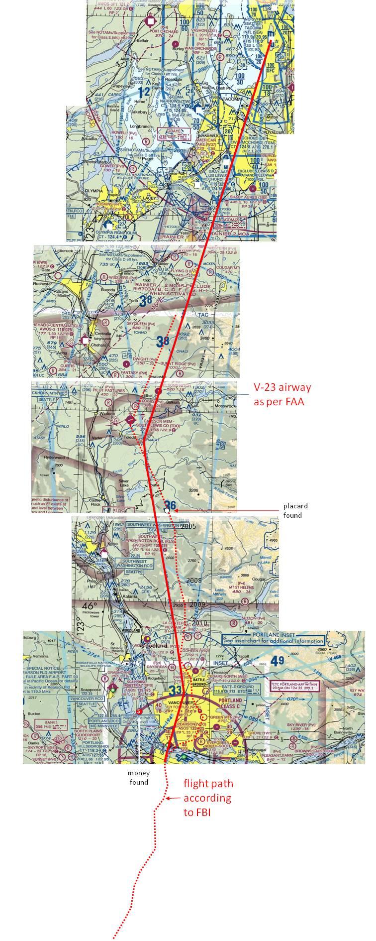

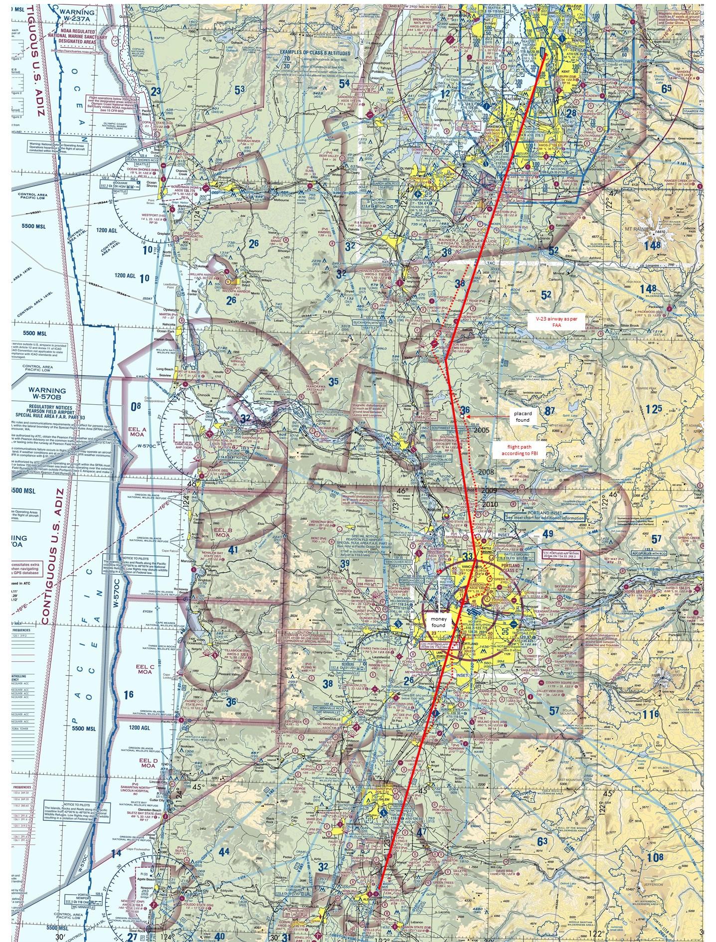

DFS346 7 #10 August 18, 2019 Attached is a plot of airway V-23 and the FBI estimate of the flight path of NWA305, between Seattle and Portland, superimposed on the current FAA aeronautical charts of Washington state. Quote Share this post Link to post Share on other sites
DFS346 7 #11 September 3, 2019 On 8/18/2019 at 10:24 PM, DFS346 said: Attached is a plot of airway V-23 and the FBI estimate of the flight path of NWA305, between Seattle and Portland, superimposed on the current FAA aeronautical charts. Here's an improved version of the map, including the flight path south of Portland, as estimated by the FBI. Quote Share this post Link to post Share on other sites
