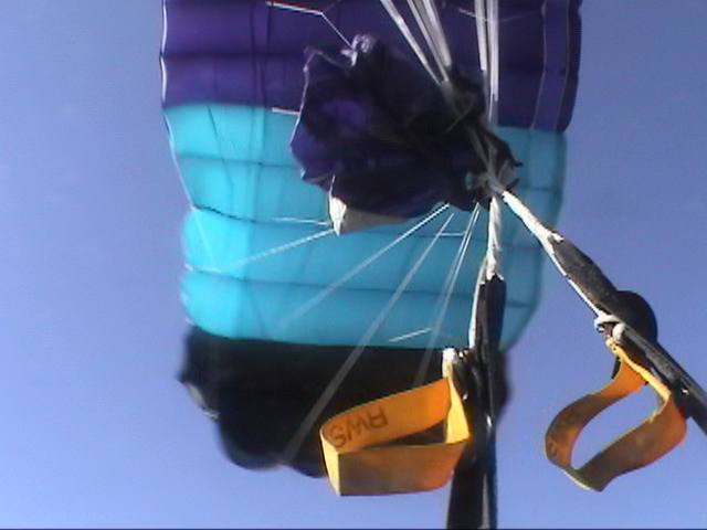

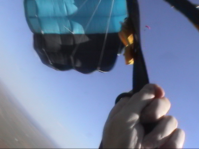

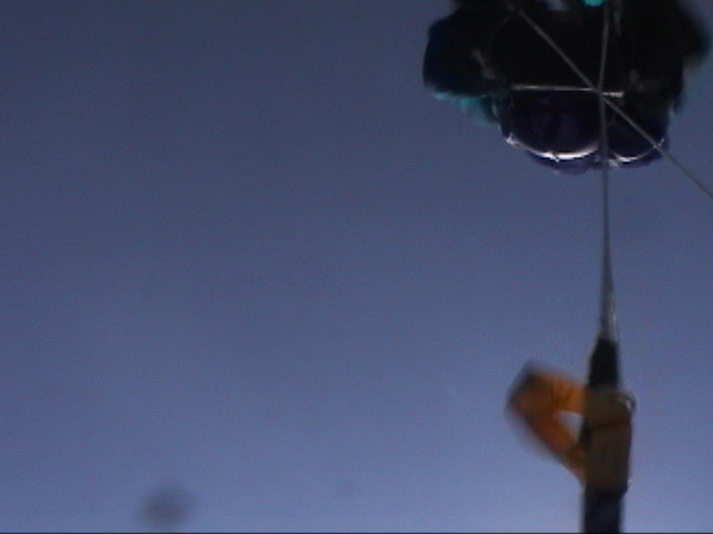

AndyMan 7 #42 September 23, 2002 Here's some pics of the line twists I had on my Stiletto (loaded at 1.6) today. 1) You can see clearly see the twists long before the canopy finishes inflating. 2) As the canopy opens, it starts to wind up. 3) Horizontal, on my back. 4) First view of connector links, both even. Canopy is straight and level. 5) Almost untwisted... After a big-way RW jump, I'd set my ditter to 2500, then had to track a bit farther to get clearence. I probably started deployment at about 2300. Elapsed time between frame 1 and 5, seven seconds. Pro-track shows a deployment altitude of 1500 feet, the same as my flat-line. I did not hear the flat-line. _Am__ You put the fun in "funnel" - craichead. Quote Share this post Link to post Share on other sites
rgoper 0 #43 September 23, 2002 AM: that's probably what mine looked like, though i'll never be able to photo-document it like you did yours. the only difference is mine had my risers spun up, toggles and all all the way to the back of my kneck. glad you got it worked out! --Richard-- "We Will Not Be Shaken By Thugs, And Terroist" Quote Share this post Link to post Share on other sites
