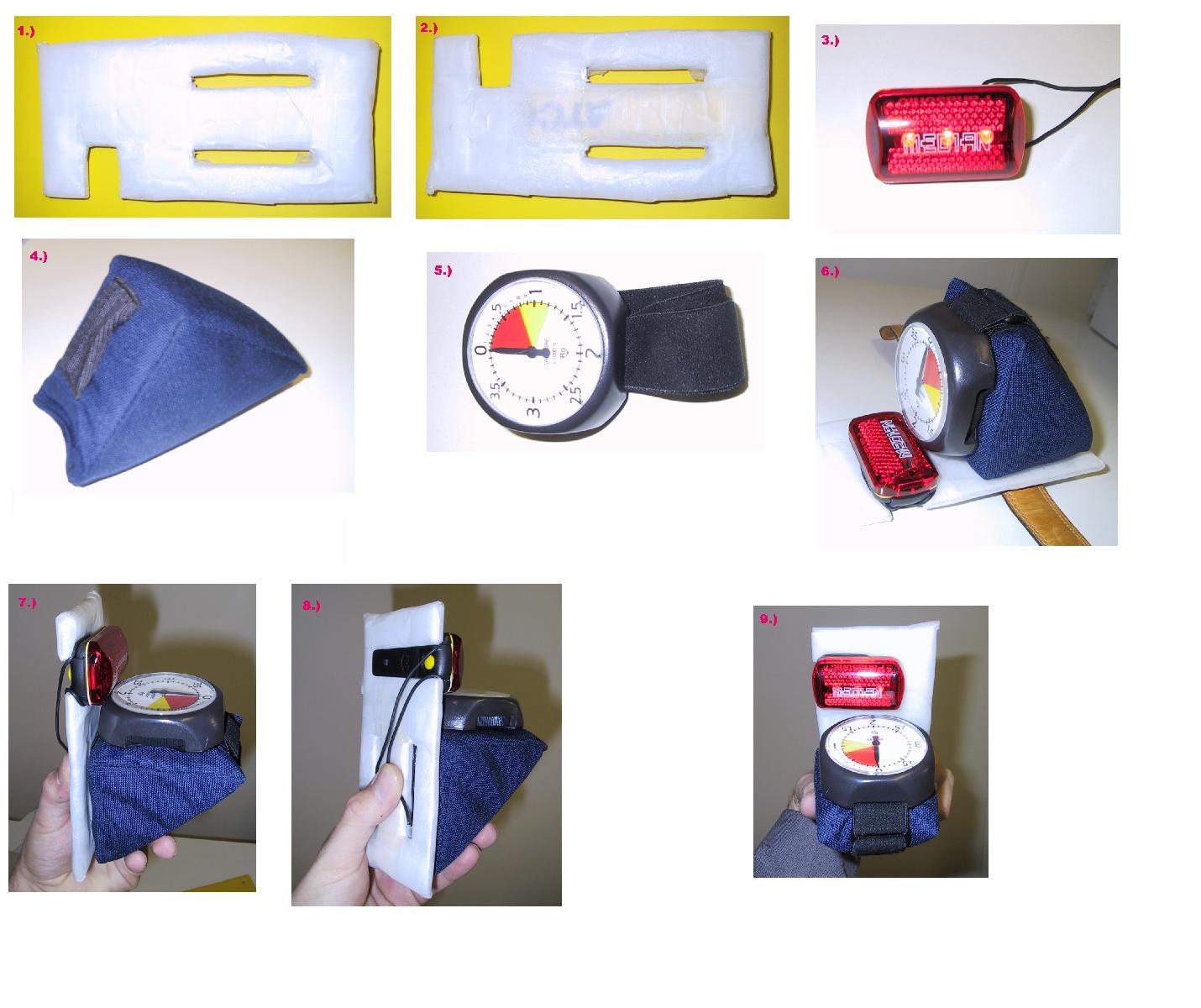

pack40 0 #1 November 18, 2002 I hope somebody can help me. Next weekend if the weather will be good I will have the possibility to have night jump(s). My problem is how to illuminate my altimeter. I have a Sapphire (Metric) altimeter. My idea was: I cut the cover page of a document folder (pretty strong paper). Applied some scotch tape, a broken ruler -for more strength- and some "sponge" (I do not know the name of it, it is some kind of an insulation material) to have a something what I can put on the chest strap to hold the flash/torch. The attached image shows it. You think it is OK? If you have some advices for the jump please tell them. Although I will jump a round chute so even with my little 44 jumps the best advice is to close my legs and face the wind. OVER Quote Share this post Link to post Share on other sites

Samurai136 0 #3 November 18, 2002 That looks like it would work. Tape the light down to your holder. I would recommend buying little glow sticks and tape them to the face of the altimeter. They are not too bright for night vision and have always worked well for me. Ken"Buttons aren't toys." - Trillian Ken Quote Share this post Link to post Share on other sites

wmw999 2,645 #6 November 18, 2002 Trying it first on a daytime jump is perfect. Your design looks OK -- the only thing I might change would be to tape over the part of the light that is facing your face, so that any glare is reduced. Reflected light is better than direct light, even if it's red. Also, go into a completely dark room to see if you can see the altimeter well enough. Have fun on your night jump. Wendy W.There is nothing more dangerous than breaking a basic safety rule and getting away with it. It removes fear of the consequences and builds false confidence. (tbrown) Quote Share this post Link to post Share on other sites

Chief 0 #9 November 18, 2002 Looks like a good design, should work. I sometimes hold a "squeeze" torch (flashlight) in my mouth. Can look up to check canopy and at alti to check altitude. Good luck and have fun! Quote Share this post Link to post Share on other sites

coconutmonkey 0 #11 November 18, 2002 We use the large chem lights on night jumps, but use gaffers or duct tape to block out all of the light except for a small slit to illuminate the face of teh altimeter. It is then taped over the face of the altimeter resting over the high altitudes, but lighting the 6000' to 0'(2000m-0m) very well. The beacon strobe is usually strapped or taped to the lower leg or gaffer tapped to the top of the helmet (good for overall visual observation and for checking the canopy).Hearts & Minds 2 to the Heart- 1 to the Mind- Home of the Coconut Lounge, Spa, & Artillery Range Quote Share this post Link to post Share on other sites
pack40 0 #12 November 20, 2002 Today I could buy 2 chem lights. Interestlingly according to Hungarian regualtions for night jumps you only have to have a torch to check you canopy after it is opened. You do not have to illuminate yourself nor your altimeter or stopwatch -I do not think nowadays would anybody jump with a stopwatch- if the freefall time is less than 10 seconds. I would suspect the altitude will be 2000m or maximum 3000m, so I will use my MAID Multipurpose-Altimeter-Illuminating-Device. Oh another question, if during the descent I will took a picture with a simple automatic camera will it work. My friend say it will not because I can use very sensitive (fast) film, but as the lenses of the cheap(shit)camera will not be open for long time I won't get a clear picture. Any Ideas? OVER Quote Share this post Link to post Share on other sites
