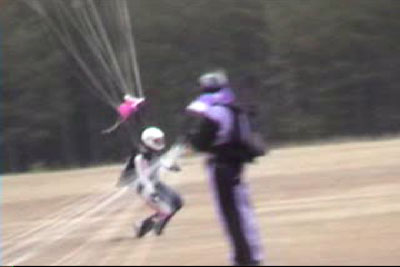

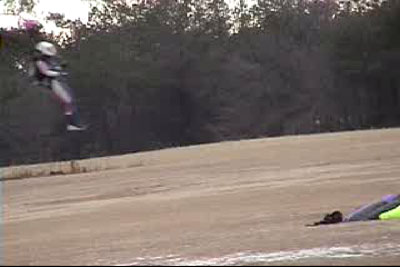

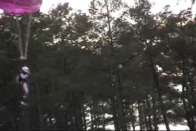

AndyMan 7 #24 February 4, 2003 Here's my thoughts. Corrections, Opinions, sly jokes always appreciated. I even grabbed a few frames off the video to illustrate my points. Take a look at the file called "TreeTop.jpg". You're a good 50 feet off the ground, and you're already starting your flare. Flaring a canopy isn't like breaking a car, starting early will NOT help you out. You also appear to be doing a very slow gradual flare. This isn't going to help you. You'll have better luck if you do a stronger flare much lower to the ground. In the file called FlareDone.jpg, you're a good six feet off the ground. You have absolutely no flight left in your canopy. It's COMPLETELY stalled. From here, you're essentially falling DOWN. Remember you want to stall your canopy right at ground zero, not ground zero + 6. Lastly, in the file called 'EvenFlare.jpg', you can see clearly that your toggles are very uneven as you finally touch down. This is what is knocking you over. _Am __ You put the fun in "funnel" - craichead. Quote Share this post Link to post Share on other sites
