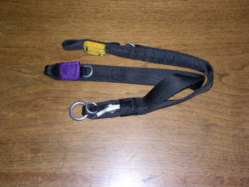

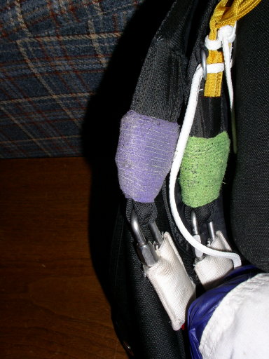

relyon 0 #15 April 30, 2003 Ok, here's a few pics of dive blocks. 1) Type XVII risers with front and rear blocks, no Vetwrap 2) Type VIII risers with front and rear blocks, Vetwrap'd 3) Same as 2) with the container closed to show the bulk. Bob Quote Share this post Link to post Share on other sites
masher 1 #16 April 30, 2003 Cool Thanks.-- Arching is overrated - Marlies Quote Share this post Link to post Share on other sites
