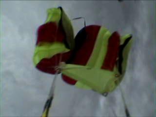

skycat 0 #12 May 6, 2003 One was packed to see if he could cut the steering line that was cause. Spin was to violent and even though he knew exactly what line to cut he couldn't do it. 2nd one cleared itself. 3rd one (steering line tied to an A line) was to get shots of a line over for a video, and spun pretty hard. All 3 were on a PD170.Fly it like you stole it! Quote Share this post Link to post Share on other sites
