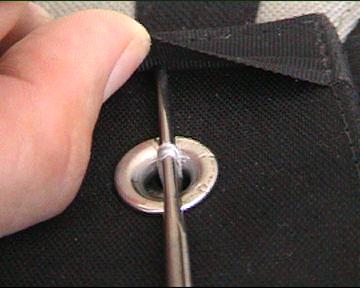

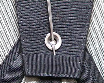

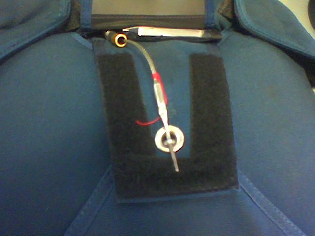

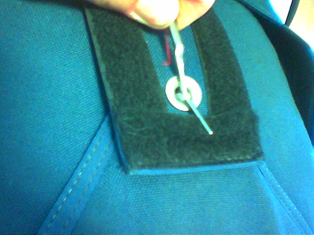

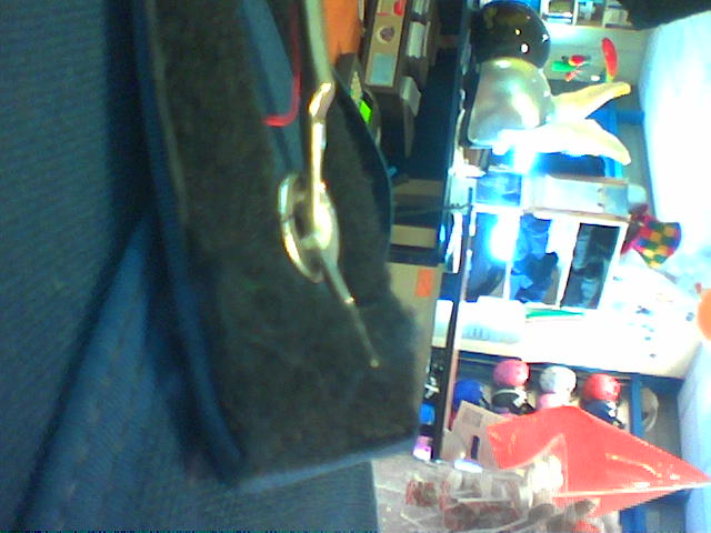

USPA 0 #1 May 7, 2003 Hi all, We had a small incident at our DZ this weekend, concerning a bent reserve pin. Jumper in question did a proper pin-check and boarded the plane, when she seated herself, she losed her balance and her rig skimed the backplate (of the airplane). Immediatly she asked for a pincheck, the jumper who performed the pincheck spotted a bent reservepin (it had "hang up" on the backplate for a second). She left the plane before taxi-out and had her pin replaced. Head's up for the good safety awareness. See attached pictures for the reserve pin.The trouble with skydiving; If you stink at it and continue to jump, you'll die. If you're good at it and continue to jump, you'll see a lot of friends die... Quote Share this post Link to post Share on other sites
Faber 0 #2 May 7, 2003 funny,my pin goes inside a "pocket"underthe velcro,that would migth have prevented this. I have a Javerlin Nj(if it matter to someone) Stay safe Stefan Faber Quote Share this post Link to post Share on other sites
darkwing 5 #3 May 7, 2003 I don't think that being under the velcro would have helped. I think the entire flap bent up. Reserves which have a tuck tab at the bottom to prevent bending up of the flap would probably not have experienced this problem. -- Jeff My Skydiving History Quote Share this post Link to post Share on other sites

riggerrob 644 #9 May 7, 2003 That reminds me of the last time I did a tandem poised exit from a Cessna - more than a decade ago. The student tried to stand up on the step and jammed me into the underside of the wing, bending a reserve pin on the underside of the door. As to the debate over whether a newer Javelin or Teardrop Superfly would have prevented this problem: I doubt it. Students have proven repeatedly, that if you slam any rig around long enough and hard enough you can bend a pin or break a closing loop. Quote Share this post Link to post Share on other sites
