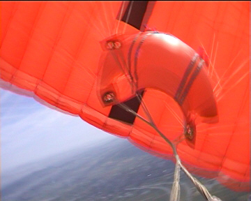

stylin 1 #1 April 1, 2003 I found this video on a website, someone with a camera was filming his own cutaways. Looks like the chute had line twist and hung slider, but the line twist didnt seem all that bad. To me, it "looks" like you could spin back out of it without too much trouble. But ofcourse Im wrong since he cutaway, and noone does that just for the hell of it. Second point, it looks like he became unstable after pulling the cutaway, or that is just his head camera moving around. Anyone wanting to know what a cutaway looks like, here it is: http://www.witched.de/VIDEO/Cutaway/cutaway.html click on a link at bottom on that page to run the video. Looking for input here, whats wrong with his chute??? Quote Share this post Link to post Share on other sites

stylin 1 #4 April 2, 2003 QuoteAny experienced skydiver would immediately recognize the issue just by looking at the still I've included with this post. Notice the angle of the horizon relative to the canopy. The canopy does not simply have line twists, but is spinning toward the ground -- an almost sure fatal if not corrected within seconds. This happens when there is uneven tension in the lines and twists lock that into place. Depending upon the canopy and the amount of twists the skydiver may elect to immediately cutaway since on some canopies, this is not a situation that can be corrected. I want to bear down on what you just said here, which has been on my mind since the beginning. "an almost sure fatal if not corrected within seconds" Thats what worries me. You have "seconds" to figure out whether or not it is just a simple line twist that can be corrected. And, in SECONDS, if youre wrong, an "almost sure fatal"? I wouldnt have this problem with something like a bag lock, real easy to make a decision on that. As far as simple, correctable line twists vs the beginning of a violent spin, it almost looks to me like you just have to throw the dice and hope you made the right decision. Quote Share this post Link to post Share on other sites

billvon 3,170 #7 April 2, 2003 >You have "seconds" to figure out whether or not it is just a simple > line twist that can be corrected. And, in SECONDS, if youre wrong, > an "almost sure fatal"? Correct. >As far as simple, correctable line twists vs the beginning of a violent > spin, it almost looks to me like you just have to throw the dice and > hope you made the right decision. Well, you have some other clues. Is the wind screaming past you? Are you starting to black out from the G forces? Can you barely get your hands over your head? Is the spin increasing in speed? Then it's probably time to get rid of it. Are you flying along in more or less a straight line, or in a gentle turn? Does it feel like your canopy is flying normally, just turning slowly in one direction or the other? When you kick do the twists start to come out? If yes, then you can probably kick out. Also, whether you're jumping a Manta or a Velocity 92 has some bearing on what you do. Quote Share this post Link to post Share on other sites

payback462 0 #9 April 2, 2003 i think it should also be noted that on the second video the jumper also has not only line twists but slider hangup from what looks like a tension knot. but, hey, hes just trolling anyway, so whats it matter to him Quote Share this post Link to post Share on other sites
quade 4 #10 April 2, 2003 QuoteSo youre saying that it is a gamble? Your words not mine. We prefer the term "managed risk". QuoteThe question is, is there a sure way to tell the difference between what is a simple line twist and the beginning of a fatal violent spin, within say 1-2 seconds? Again, just look at the picture I posted previously. Simple line twists will have the canopy all the way up in the blue part of the sky. Spinning line twists will put the canopy closer to the horizon -- and you'll feel the g-forces building up as well. On video it may be difficult to tell what the issue is if you're an inexperienced skydiver, but I think even a first jump student would probably recognize the situation almost instantly during an actual skydive. On a student canopy, the spin would not be so bad that you wouldn't have a few more seconds to figure out what to do. On a more advanced canopy, the spin could create g-forces so great that you'd have to react immediately or run the risk of blacking out. Too bad you pissed off Michele. She could tell in much better detail the story about how she had a very similar situation occur during her AFF progression.quade - The World's Most Boring Skydiver Quote Share this post Link to post Share on other sites
Hooknswoop 19 #11 April 2, 2003 That pic looks like it has at least one step-through in the lines. Hook Quote Share this post Link to post Share on other sites

quade 4 #13 April 2, 2003 Maybe. It's kind of irrelevant to the discussion though. Could just be that the lower lines are twisted up a lot. Again, it's kind of irrelevant how the skydiver actually got that way, the important thing is he made the correct choice to chop it and maybe somebody can learn from that.quade - The World's Most Boring Skydiver Quote Share this post Link to post Share on other sites

hookitt 1 #17 April 2, 2003 Take a look at the video. (3 megs) He gets out of the line twists and the step through appearance is gone. It was still spiraling when he got out of the twists and it was cutaway quickly there after.My grammar sometimes resembles that of magnetic refrigerator poetry... Ghetto Quote Share this post Link to post Share on other sites
