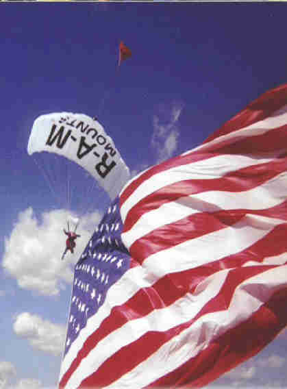

airtwardo 7 #5 June 5, 2003 Bill, It was probably a 20 X 40...800 sqft. That is pretty much the industry standard, there are a ton of them around. Our 39X59 comes in at around 85 lbs. and it too is jumped using a tandem 'like' system. Special design from Strong...similar hardware and drouge system. No cert. for passengers. Here is a pic of our 2300 sqft. that gives a better idea of scale. ~ If you choke a Smurf, what color does it turn? ~ Quote Share this post Link to post Share on other sites

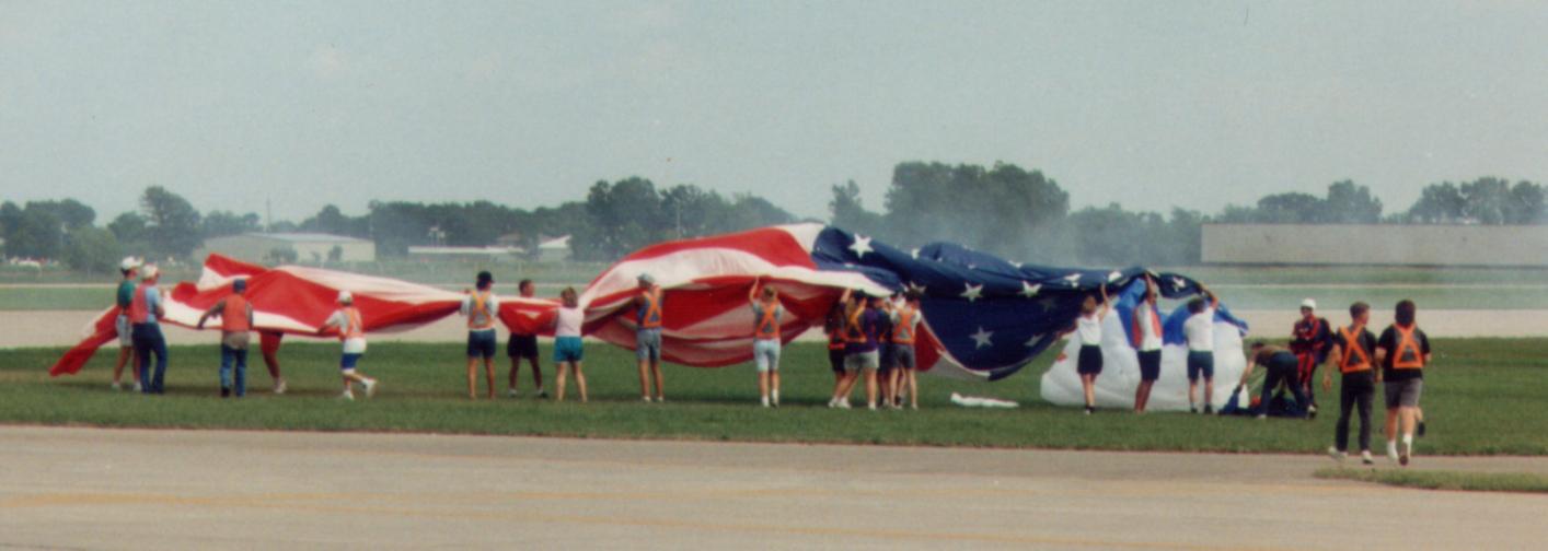

airtwardo 7 #7 June 5, 2003 ...Couple more shots of "Mega Glory" It's being flown under a Set 425 The Pow-Mia flag is a 15X25 ~ If you choke a Smurf, what color does it turn? ~ Quote Share this post Link to post Share on other sites

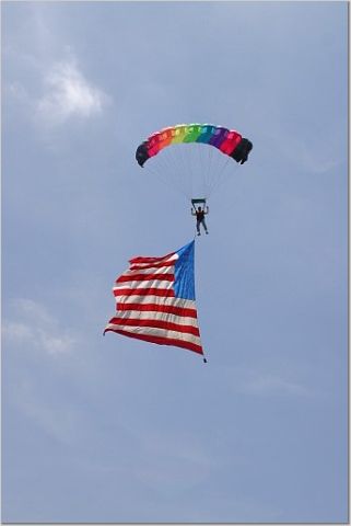

airtwardo 7 #15 June 5, 2003 Paul- Is he jumping that on a standard sport harness? From the picture it looks like it's tied into the chest strap?? ~ If you choke a Smurf, what color does it turn? ~ Quote Share this post Link to post Share on other sites

quade 4 #17 June 5, 2003 Yep, it's a standard sport harness. Clips into the hip rings and gets threaded through the chest strap. There's a cutaway for flag, but I don't think there is one for the bag. You'll notice a big hook knife on the front of the bag as well. He's been jumping it this way for awhile. Ya might want to contact him directly for more precise details. I'm a total newbie to all of this demo stuff -- my Pro card is on file with the USPA, but I haven't received it in the mail yet.quade - The World's Most Boring Skydiver Quote Share this post Link to post Share on other sites

airtwardo 7 #19 June 5, 2003 QuoteJim Wallace has and flys a 1000^2 ft and a 2000+^2 ft (not at the same time -- obviously). Here's a poor quality shot...but it's of a 800 sqft, a 600 sqft. and a 400 sqft. being flown at the same time... second pic is from last years EAA calender... That's a 20X40... ~ If you choke a Smurf, what color does it turn? ~ Quote Share this post Link to post Share on other sites
