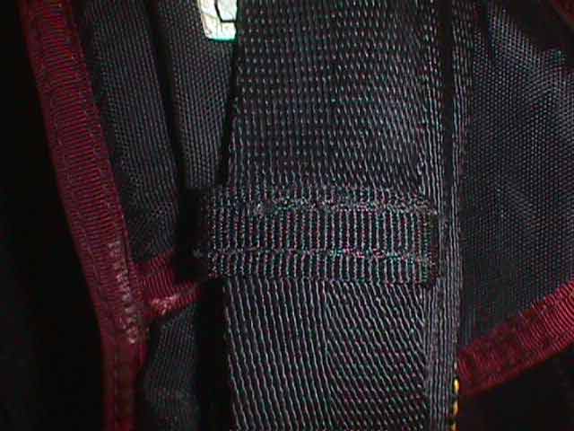

MrHixxx 0 #26 May 6, 2003 Here is what I have on my front risers (sliderstop). It is like a second confluence wrap with the top and bottom sides of the tape turned under on the front riser only about 2" up from the riser's confluence wrap. It is just a little wider than the slider grommet so you can easily pull it over, but it won't float back up. I grab the rear slider grommets first and sandwich them under the front grommets with the sliderstops on the front risers and it stays put, simple and effective. The slider stow I use I made from a hard plastic ball that came off of a bungee that I found in the auto section at Walmart. The elastic cord comes from a fabric store. I took a dremel and drilled a second hole about 135 degrees from the mounting loop for the stow loop. I pull the slider down and wrap the stow loop around the fat side of the ball. Now it should be tight enough to hold it with a few pounds of pressure, but if you pick the rig up by it, it should release (for a cutaway). By adjusting the size of the stow loop, you can make it release easier or harder. Note: I ended up cutting my mounting loop, tieing knots in the ends and super tacking it just under the binding tape on my top reserve flap cover. I did this so it cannot come off and interfere with a regular reserve deployment. -Hixxx death,as men call him, ends what they call men -but beauty is more now than dying’s when Quote Share this post Link to post Share on other sites
hookitt 1 #27 May 6, 2003 QuoteHow long is the original piece of 1 inch type 4 before you fold it in half? You can wing it on the size. Mine started at about 2 3/4 inches. Fold one end over about 3/8ths in and fold the other end up to meet it.My grammar sometimes resembles that of magnetic refrigerator poetry... Ghetto Quote Share this post Link to post Share on other sites

riggerrob 643 #49 January 10, 2004 Slider-catchers -sewn to risers - offer the best of both worlds. While working for Rigging Innovations, I installed a few sets of the tuck tab style and Sandy Reid reports that he has been selling lots of them lately. More recently I have installed a few triangular slider-catchers. Quote Share this post Link to post Share on other sites
