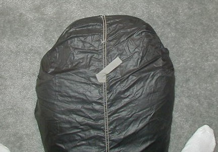

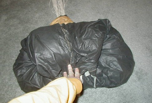

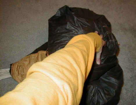

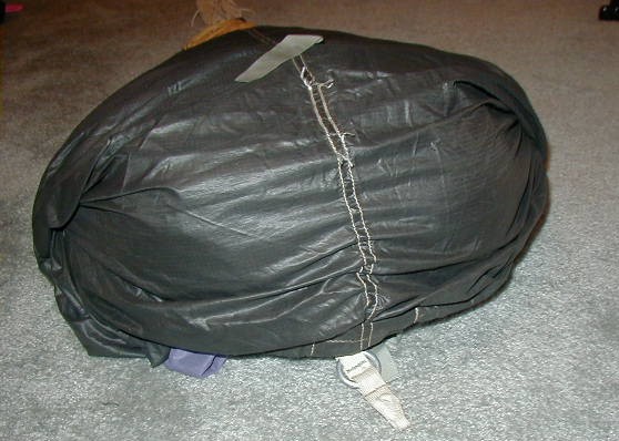

When laying down on the canopy squishing the air out of it, look for the tape that runs from the bridle attachment point to the ribs. Then take the ears (that material at the top of the canopy that goes everywhere) and stuff them in the pocket that is created behind the tape on the center cell. Now the center cell is holding all the rest of the top of the canopy in place. From there follow canuck's instructions on folding the top half 1st, putting that in the D-bag, then the bottom half and putting that in the D-bag.
I've used this on every canopy I've ever jumped wether it's new ZP or old. I have really small hands and with this I have no problem controling anything from my new crossfires (I'd never psycho pack a crossfire) to the 1st packjob on Steve's sabre2 170.
