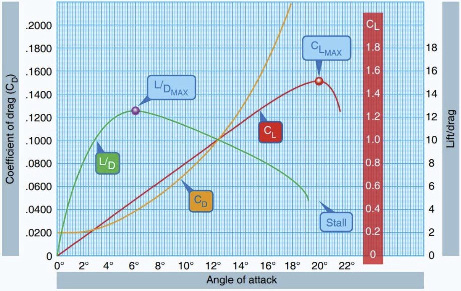

billvon 3,171 #45 June 20, 2024 On 6/18/2024 at 1:46 PM, Veis said: It doesn't work that way He's exactly right. Let's take an example. A student pilot is departing an airport. He wants to climb faster - he wants more lift! So he pulls the yoke back as much as he can. His climb rate increases - but his speed falls off. When the wing reaches about 15 degrees angle of attack, he feels the buffeting of an incipient stall. What should he do? If he wants to get "the maximum possible lift force" as you mentioned before, he should pull back further. That will maximize his lift. Up to about a 40 degree angle of attack, more pitch up equals more lift. If he wants to survive, he reduces the angle of attack. This decreases lift slightly but GREATLY decreases drag, so that he can keep climbing with the thrust he has available in the engine. You almost never want "the maximum possible lift force" in airplanes OR parachutes. Quote The drag of a the front part of the wing is a way to make the air move in a certain direction, and create lift. Nope. Drag does not "make the air move in a certain direction" and it does not "create lift." Drag is the result of the aerodynamic forces acting to slow the wing. The front of a ram air parachute is open because the dynamic pressure caused by the motion of the parachute with respect to the relative wind keeps the canopy slightly pressurized, which causes it to keep its shape. That happens due to the momentum of the air, the pressure behind that air and the stagnation point in front of the wing - not because of drag. If you sealed off the front of the wing completely and pressurized it from another source (a compressed air bottle for example) you'd get a very similar amount of lift. 1 Quote Share this post Link to post Share on other sites
pchapman 281 #46 June 20, 2024 (edited) Getting aerodynamic principles just right, and explaining them correctly, is quite tricky. There are plenty of ways to explain something that are "sorta kinda right in some circumstances, for the example being given, but not sufficiently correct to really explain most of the possible situations". And this particular discussion has been messed up by one participant not having really good command of the English language. Not his fault, but makes explanations and interpretations even more confusing & sketchy & vague. I'll certainly disagree with Veis on a lot of his aerodynamics. Although I do agree that the Kutta condition or Kutta-Joukowski don't imply that neighbouring air molecules, one going over and one going under an airfoil, need to meet up again at the trailing edge. That just isn't true. So, billvon, I don't think that is a useful part of how to describe lift. I'll wimp out from wading too far into this, as writing a good textbook explanation of lift is hard. But I'd say: 1. Lift comes from pushing air down. [Circulation in other words, if doing Kutta-Joukowski integration around the whole airfoil stuff] Edit: That's simple Newton's laws stuff, or force diagrams. Pushing air down means you have pushed up on the wing. 2. You can do that with a flat plate, the so-called barn door, at some angle of attack, catching the air. No curved airfoil needed. But, it is a very inefficient way to make lift, as there's a ton of drag for the lift being produced. (At the sizes and speeds we are talking about. Things are different at the sizes & speeds of paper airplanes and insects. [Small Reynolds numbers ]) 3. Airfoils happen to be a shape that can make lift, while still being really low drag. Very efficient, that's why we use them. 4. There is some pressure pushing up on the bottom of airfoils if at enough angle of attack. [This gets complex and depends on exact shape & angle] 4. But most of the lift comes from the top: The way air works is that it speeds up and lowers pressure when moving around a gently curved surface. That's where the Bernoulli stuff come into play. That provides most of the lift of an airfoil. 5. But the air can't turn too sudden of a corner. So at too high an angle of attack, the air starts to separate from the surface of the wing and turns into a swirling chaotic mess of waves and vortexes. The airfoil has stalled. Lift starts to decrease* but drag is massively up, so you no longer have an efficient airfoil and your airplane or parachute is probably going to start dropping suddenly (assuming we are talking about roughly horizontal flight), leading to even higher angle of attack and even lousier flying. *[Edit: Duh somehow I said it was still increasing. Which isn't true for a regular airfoil after the stall. What I should have said is that one can have very low aspect ratio aircraft, or aircraft with strakes, or a wingsuit, or something, where there isn't a simple clean stall. Parts of the wing may not be working efficiently, and there's increasing drag, but lift from say vortexes can keep on rising past say 15 degrees to say 40 degrees angle of attack. The concept of "the stall" isn't as clear cut any more.] Edited June 20, 2024 by pchapman Quote Share this post Link to post Share on other sites
Veis 29 #47 June 20, 2024 4 hours ago, billvon said: He's exactly right. Let's take an example. A student pilot is departing an airport. He wants to climb faster - he wants more lift! So he pulls the yoke back as much as he can. His climb rate increases - but his speed falls off. When the wing reaches about 15 degrees angle of attack, he feels the buffeting of an incipient stall. What should he do? If he wants to get "the maximum possible lift force" as you mentioned before, he should pull back further. That will maximize his lift. Up to about a 40 degree angle of attack, more pitch up equals more lift. You're both wrong. I do not know the source of your fantasy, where did you read that an increase in the angle of attack leads to an increase in lift? In such a situation, the lift is increased by the release of the front and/or rear wing mechanization. Slat - makes the flow around the upper surface of the wing more dynamic, and creates a larger bubble of low pressure air. And the flap increases the surface, which perceives this low pressure from above and increased pressure from below. Quote Share this post Link to post Share on other sites
olofscience 495 #48 June 20, 2024 14 minutes ago, Veis said: In such a situation, the lift is increased by the release of the front and/or rear wing mechanization. When you pull the yoke of an aircraft, nothing happens on the (front) wing. If I were to use your words - no release of mechanization happens. Lift coefficient would still increase though. Quote Share this post Link to post Share on other sites
billvon 3,171 #49 June 20, 2024 20 minutes ago, Veis said: You're both wrong. I do not know the source of your fantasy, where did you read that an increase in the angle of attack leads to an increase in lift? I'm a pilot and I know that from experience; it's how airplanes work. You can also read it in any book about aerodynamics. But if you want a nice chart see below. (Note that this airfoil maxes out lift at about 20 degrees, not 40 degrees.) Quote In such a situation, the lift is increased by the release of the front and/or rear wing mechanization Nope. During normal flight, lift is increased by increasing the angle of attack. This is done by deflecting the elevators on the back of the horizontal stabilizers using the yoke/stick. Nothing to do with "mechanization" on the wing. What you are talking about - flaps and slats - are only used during takeoff and landing, to reduce stall speed so that the aircraft can take off/land at a slower airspeed. But don't take my word for it. Take a flying lesson and see for yourself. Or just look out the window of an airplane next time you are in one. Quote Share this post Link to post Share on other sites
Veis 29 #50 June 20, 2024 19 minutes ago, billvon said: I'm a pilot and I know that from experience; it's how airplanes work. You can also read it in any book about aerodynamics. You have read familiar words, and you are arguing with the theses that you put forward yourself. What does the dependence of lift on the angle of attack have to do with it? I was talking about a profile that provides maximum lift for a given wing area, and speeds acceptable for a landing human body. Quote Share this post Link to post Share on other sites
