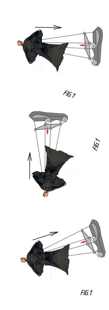

Veis 29 #1 Posted June 9, 2024 (edited) 1 hour ago, GoneCodFishing said: That drawing breaks so many laws of physics that just looking at it my ocd is peaking to the point it'll creae northern lights visible in the whole of the northern hemisphere There are many atavisms and myths in parachutes they are based on the "knowledge" of physics... The slider was invented for vertical openings because there were no others at that time. In horizontal opening, the body towing the parachute with its mass, forcing it to rise during deployment, like any wing. Like for paraglider or kite. A short pushing of the flow alongside the surface of the slider is enough for it to fall. Edited June 9, 2024 by Veis 2 Quote Share this post Link to post Share on other sites
GoneCodFishing 24 #2 June 9, 2024 (edited) 57 minutes ago, Veis said: There are many atavisms and myths in parachutes they are based on the "knowledge" of physics... The slider was invented for vertical openings because there were no others at that time. In horizontal opening, the body towing the parachute with its mass, forcing it to rise during deployment, like any wing. Like for paraglider or kite. A short pushing of the flow alongside the surface of the slider is enough for it to fall. The slider doesn't know what or where is neither horizontal nor vertical. All it knows is relative wind. If the jumper is moving in the direction of the arrow (so the arrow points the direction of the relative wind) then the canopy would have lined up with the arrow as well. Here's a horizontal deployment, a vertical deployment, and a deployment with a glide angle as above, as they happen in the real world Edited June 9, 2024 by GoneCodFishing Quote Share this post Link to post Share on other sites
Veis 29 #3 June 9, 2024 (edited) 5 hours ago, GoneCodFishing said: The slider doesn't know what or where is neither horizontal nor vertical. All it knows is relative wind. If the jumper is moving in the direction of the arrow (so the arrow points the direction of the relative wind) then the canopy would have lined up with the arrow as well. Here's a horizontal deployment, a vertical deployment, and a deployment with a glide angle as above, as they happen in the real world This is a common misconception. The wing always "knows" where the top is - because the lifting force is always directed upwards (just like the Archimedean force), in the opposite direction to gravity. And the parachute, even at the beginning of the opening, is a wing. At horizontal openings, the towed bucket formed by the skin and the slider rakes the air mass . The slider is a piston, and if the pressure from above, from the volume limited by the skin, turns out to be more than from below, it will inevitably fall. And this happens from time to time, more often than we would like. Edited June 10, 2024 by Veis 1 Quote Share this post Link to post Share on other sites
Remster 30 #4 June 10, 2024 (edited) 17 hours ago, Veis said: This is a common misconception. The wing always "knows" where the top is - because the lifting force is always directed upwards (just like the Archimedean force), in the opposite direction to gravity...... No, it is definitely not. Lift is perpendicular (90deg) to the motion of the wing in the fluid (the air in our case). You can't reinvent physics. Edited June 10, 2024 by Remster 2 Quote Share this post Link to post Share on other sites
Veis 29 #5 June 10, 2024 1 hour ago, Remster said: No, it is definitely not. Lift is perpendicular (90deg) to the motion of the wing in the fluid (the air in our case). You can't reinvent physics. This misconception has nothing to do with physics. A parachute unpacked upside down from the bag never tends to dive under the trajectory - it turns over, and always rise only upwards, but with a line twist. The lifting force is indeed related to Archimedean, since it comes from inertia and the interaction of volumes of moving air of different densities. For the same reason, modeling an airplane in a vertical wind tunnel is not equivalent to a horizontal one. Quote Share this post Link to post Share on other sites

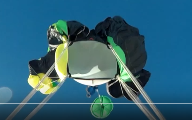

wolfriverjoe 1,523 #19 June 15, 2024 11 hours ago, Veis said: Ok, please explain to me how the slider can be almost all the way up, yet the canopy is nearly fully inflated. With the slider that far up, there's no way the canopy can have any form other than a big ball. It will be directly downwind (relative wind) from the container. It doesn't matter if the jumper is falling straight down, moving both down and forward, or moving entirely (or almost entirely) forward. So the airflow would be going directly against the bottom of the slider and the canopy. Not from the front. There are literally thousands of videos that will show this. Quote Share this post Link to post Share on other sites
billvon 3,170 #20 June 15, 2024 12 hours ago, Veis said: However, the aerodynamic structures that I develop and produce according to the "wrong" theory are quite workable. Absolutely. I once spoke to a pilot with around 5000 hours who was convinced that aircraft generated lift because the top of their wing was curved. When I asked how aircraft flew upside down, he claimed that their engines, not lift, kept them aloft. When I asked how gliders could fly upside down he paused for a moment then said "they can't." Now, this guy was, as far as I could tell, a fairly good pilot, so his misconceptions had not hurt him. But we can all hope he learns a little more about aerodynamics before he tries to fly any aerobatics (if he ever does.) And especially before he tries his hand at aircraft design. Quote Share this post Link to post Share on other sites
Veis 29 #21 June 15, 2024 7 hours ago, wolfriverjoe said: 19 hours ago, Veis said: Ok, please explain to me how the slider can be almost all the way up, yet the canopy is nearly fully inflated. The answer is simple: the figure shows the center section, this happens when the wing is inflated about the width of the slider. And in the video, the wing is turned 90 degrees, with the stabilizer on the stream. It doesn't make much matter. This is how the filling of the center section looks like in experiments with a towing system. Quote Share this post Link to post Share on other sites
wolfriverjoe 1,523 #22 June 15, 2024 3 hours ago, Veis said: The answer is simple: the figure shows the center section, this happens when the wing is inflated about the width of the slider. And in the video, the wing is turned 90 degrees, with the stabilizer on the stream. It doesn't make much matter. This is how the filling of the center section looks like in experiments with a towing system. Ok, it's only a partial representation of the canopy. Misleading, but ok. However, the wind vector in your drawing is coming from the front. It's pretty clear from the pilot chute that the wind is coming from 'below' the canopy in the picture. Along with the way the slider is blown upwards. Quote Share this post Link to post Share on other sites
BIGUN 1,520 #23 June 15, 2024 9 hours ago, billvon said: who was convinced that aircraft generated lift because the top of their wing was curved. Help me understand why this was wrong. He was probably relying on Bernoulli's theorem which we all learned while getting our pilot's license. 9 hours ago, billvon said: When I asked how aircraft flew upside down, he claimed that their engines, not lift, kept them aloft. I wonder if he was implying the engines were needed to maintain lift. Quote Share this post Link to post Share on other sites
Veis 29 #24 June 15, 2024 (edited) 1 hour ago, wolfriverjoe said: Ok, it's only a partial representation of the canopy. Misleading, but ok. However, the wind vector in your drawing is coming from the front. It's pretty clear from the pilot chute that the wind is coming from 'below' the canopy in the picture. Along with the way the slider is blown upwards. In the photo with the towing system attached to the slider, as a full RDS, it can be seen that the lines direction is rotated at a significant angle to the weather vane (PC). The angle is about 45 degrees - but with a large suit, and when performing a "braking" this angle will be smaller, but shading and low pressure area larger. For these reasons, but not because of the lesser desire to rise by deployed wing. Edited June 15, 2024 by Veis Quote Share this post Link to post Share on other sites
