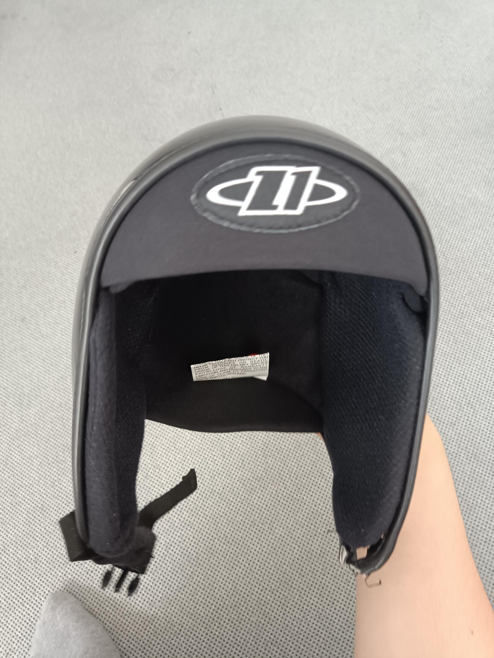

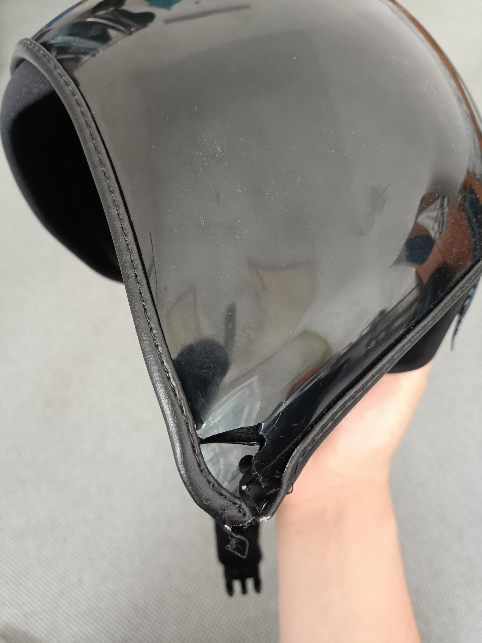

speciolist_ 1 #1 Posted August 15, 2023 Hai! On my helmet parasport z1, the fastex broke, or rather, the part of the helmet itself broke on which the fastex rests. Can you tell me how to fix this and is it possible? I'll leave a photo here. Thank you 1 Quote Share this post Link to post Share on other sites
billvon 3,111 #2 August 16, 2023 It will be difficult. If you have worked with fiberglass before, you'll have to lay down a few layers in that area (after prepping the surface) then finish to your liking. You probably can't reuse the edging since the repair will be thicker but you could try it. You will likely be switching to a nut and bolt to hold the strap on; that will take some filing and filling to make sure there are no snag points on the finished helmet. 1 Quote Share this post Link to post Share on other sites

speciolist_ 1 #4 August 18, 2023 Yes, thank you for your answers, I have a new Kiss helmet, but I just wanted to restore this one somehow, but I think this is unlikely to work. On 8/17/2023 at 12:48 AM, skyderrill66 said: Buy a new helmet your life is worth more than the price of a new helmet On 8/16/2023 at 11:15 PM, billvon said: It will be difficult. If you have worked with fiberglass before, you'll have to lay down a few layers in that area (after prepping the surface) then finish to your liking. You probably can't reuse the edging since the repair will be thicker but you could try it. You will likely be switching to a nut and bolt to hold the strap on; that will take some filing and filling to make sure there are no snag points on the finished helmet. On 8/17/2023 at 12:48 AM, skyderrill66 said: Buy a new helmet your life is worth more than the price of a new helmet Quote Share this post Link to post Share on other sites
