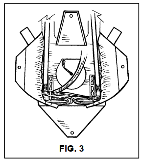

pchapman 280 #4 August 3, 2023 2 hours ago, riggerrob said: The only limitation is that round reserves need Type 3 or Type 4 diapers - with all suspension lines stowed on the diaper. Haha! (As you might say) There's more to the situation: The old Jav's actually did have reserve tray loops for non-diapered round reserves. Going from one of those old manuals that Gowler refers to: Quote Share this post Link to post Share on other sites

riggerrob 644 #6 August 7, 2023 On 8/3/2023 at 11:19 AM, pchapman said: Haha! (As you might say) There's more to the situation: The old Jav's actually did have reserve tray loops for non-diapered round reserves. Going from one of those old manuals that Gowler refers to: Wow! The Javelin factory (aka. Sunpath) deleted those line stows so long ago that I forgot about them. I have only packed a few rounds into Javelins and they all had full-stow diapers (Type 3 or Type 4). On a practical level, Type 1 deployment (with all line stows in the pack tray) may have worked at the low airspeeds that were fashionable when we skydived from pterodactyls (humor) or AN-2 biplanes that fly backwards in a gentle breeze (more humor). But ever since freefall speeds exceeded 100 knots, we really needed diapers that would hold the skirt closed until we reached line stretch. While Strong's Type 1 diaper (2 or 3 stows of the left line group on the diaper with the rest in the pack tray) provides a huge improvement in reliability, it is difficult to teach to young riggers. I only pack Type 2 diapers into Strong Para-Cushions. Strong Para-Cushions need those line stows to serve as kicker-plates/launching pads for their pilot-chutes. For almost every other container, I just stow all the lines on the diaper. On a practical level, Type 1 deployment fell out of fashion during the 1970s. For all practical purposes, Type 1 deployment is obsolete. While working for Butler, I manufactured hundreds of Type 4 diapers and sewed them onto the full range of older round canopies. Quote Share this post Link to post Share on other sites

pchapman 280 #10 August 10, 2023 (edited) This is the earliest all digital Javelin manual I have, with the file dated 2004. (not sure when it actually came out.) The next version I have is Rev02 in 2007, because then Skyhooks were added as an option. Javelin Rev01-Issue01.pdf Edited August 10, 2023 by pchapman Quote Share this post Link to post Share on other sites
