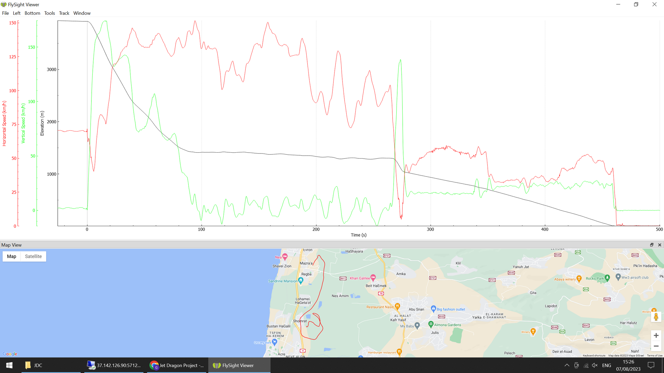

Gideon Yampolsky 38 #28 August 7, 2023 (edited) Results so far ... 6L of fuel consumed. I'm still learning how to fly it efficiently jet_powered_ws.CSV Edited August 7, 2023 by Gideon Yampolsky Quote Share this post Link to post Share on other sites

the.Legend 55 #30 October 9, 2023 (edited) On 8/7/2023 at 2:31 PM, Gideon Yampolsky said: Results so far ... 6L of fuel consumed. I'm still learning how to fly it efficiently jet_powered_ws.CSV 4.53 MB · 1 download Congratulations on pulling this off! May I ask what's the biggest challenge in maintaining constant horizontal speed? Did you have thrusters "On" at constant RPM all the time or was it impulse acceleration? Edited October 9, 2023 by the.Legend Quote Share this post Link to post Share on other sites
Gideon Yampolsky 38 #31 October 16, 2023 During the entire flight RPM was 97,000 which is turbines' maximum. As you can see in Flysigh recording horizontal speed was not constant. This because I was experimenting with body position. When I increased pitch (i.e. tried to “fly up”) I lost some of horizontal speed but managed to achieve level flight and even climb up a little bit. My conclusion after experiments is, that with engines thrust, the optimal flight characteristics are different than in the case of regular wingsuit. Optimal flight speed with ATC wingsuit is around 150 Km/h. But with engines I found that optimal speed is around 110 Km/h, in body position aiming to “fly up”. I’m planning to experiment more in future. But prior to further flights I have to make significant changes in some of system components, which will take time. Sadly saying Israel went through horrifying event 10 days ago, which drew us into an unexpected war. So currently we have completely different priorities. Quote Share this post Link to post Share on other sites

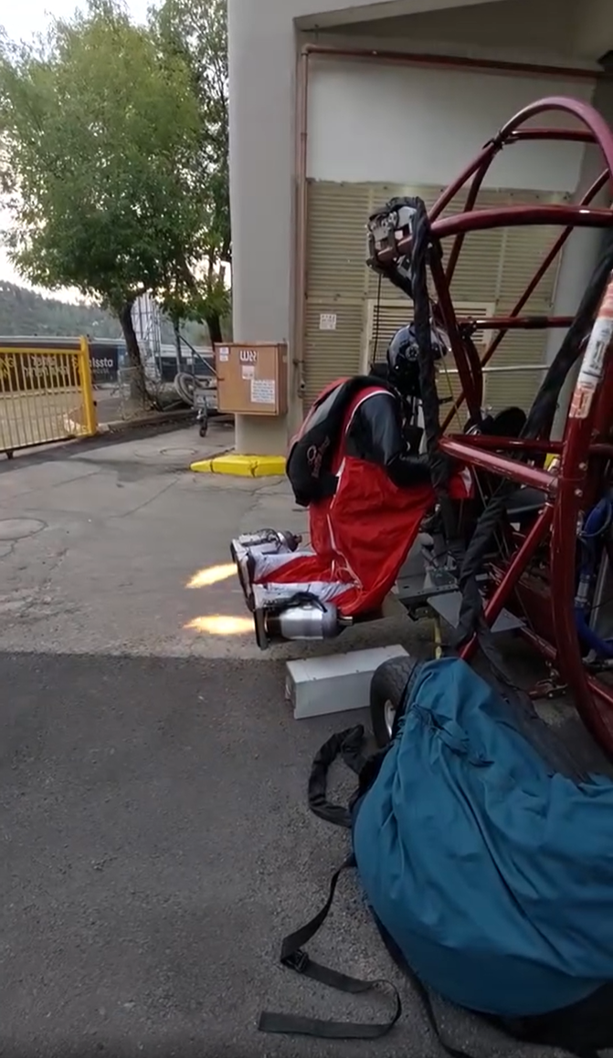

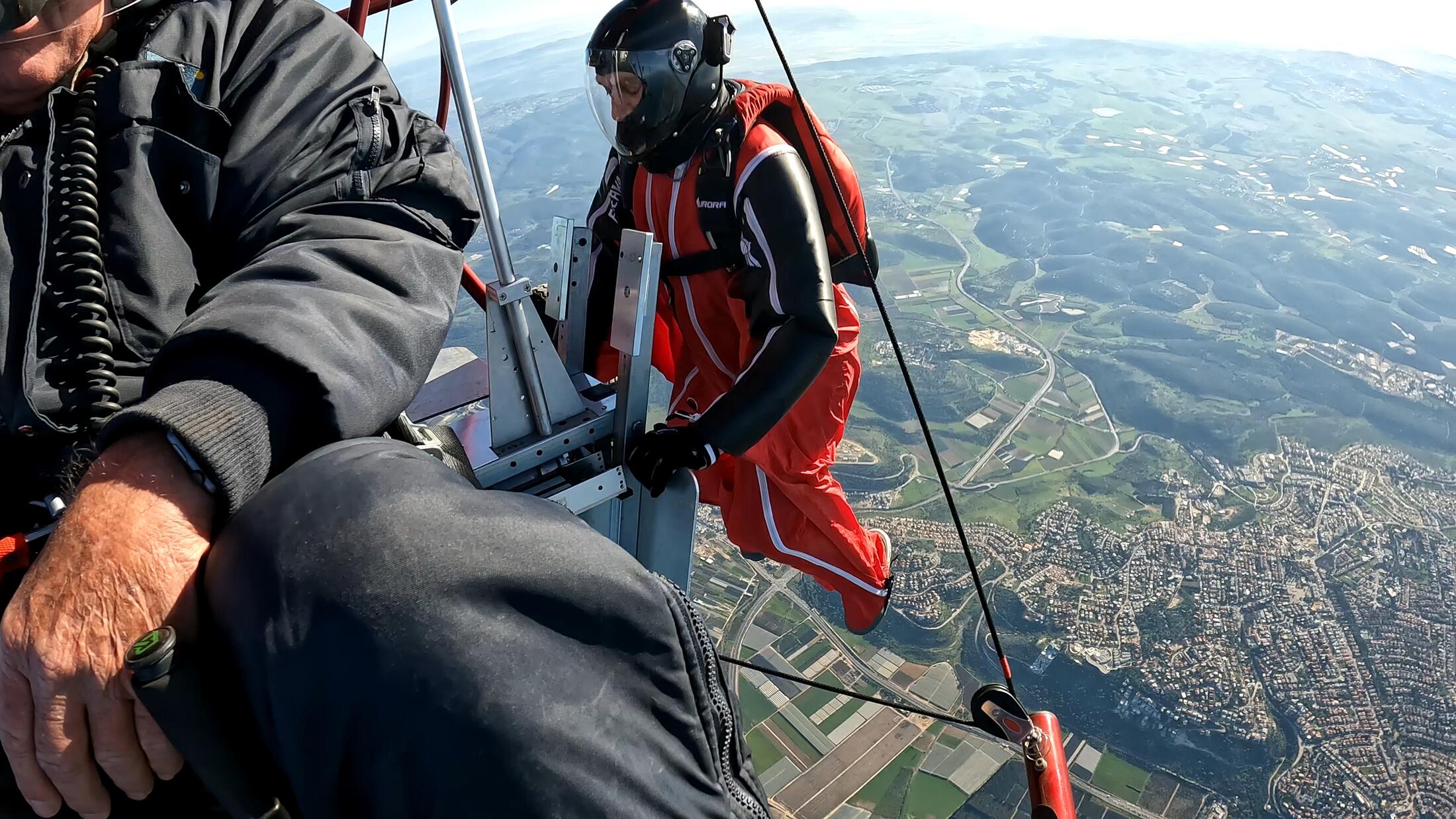

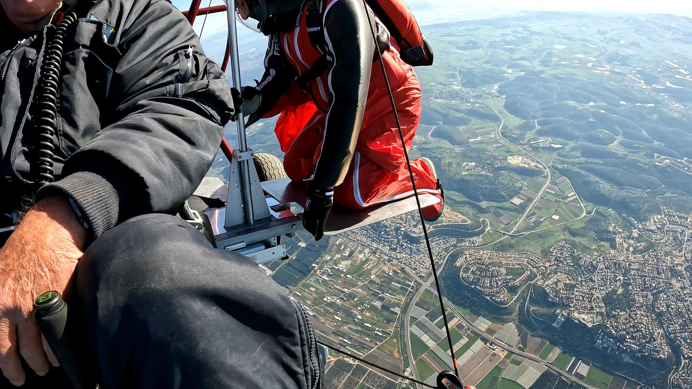

SethInMI 174 #43 August 14, 2024 the "trapdoor shelf" is working well? Did you build and design that yourself? Sounded like you did. What is the return mechanism after you leave? A spring? Quote Share this post Link to post Share on other sites
Gideon Yampolsky 38 #44 August 14, 2024 46 minutes ago, SethInMI said: the "trapdoor shelf" is working well? Did you build and design that yourself? Sounded like you did. What is the return mechanism after you leave? A spring? The automatic shelf is working well. Build by me. Return mechnism is based on servo motor with gear, a kind used in robotic arms. WhatsApp Video 2024-08-14 at 16.03.03.mp4 Quote Share this post Link to post Share on other sites
SethInMI 174 #45 August 14, 2024 pretty sweet. Did you think about the "what if the motor doesn't work" case? It looked like the shelf had to come up for a good landing. Quote Share this post Link to post Share on other sites
Gideon Yampolsky 38 #46 August 14, 2024 47 minutes ago, SethInMI said: pretty sweet. Did you think about the "what if the motor doesn't work" case? It looked like the shelf had to come up for a good landing. If motor will not take the shelf up, pilot can pull it manually. If not, landing with shelf hanging would not be nice, but probably it would not be a crash. Since it is paraplane, pilot can bring it to nearly zero horizontal velocity by flaring the canopy, same as with our landings. Quote Share this post Link to post Share on other sites
Gideon Yampolsky 38 #47 August 14, 2024 (edited) But the funny thing is that I’m no longer using it. Explanation: In past I was reluctant to fall on the back with jets running. I built that automatic launching shelf with aim to drop me down straight on the belly. But it did not happen. Every time I found myself on the back right after the drop. So I decided to accept it. I practiced uncontrolled fall out on the back from Skyvan, until I obtained a good habits to make quick and controlled transition. From there, automatic launching shelf was no longer required. I replaced it with smaller equivalent permanently mounted shelf. I kneel on it, engines facing outwards, start engines, and then flip myself backwards, like scuba divers from the boat. In two seconds I’m back on the belly. It works pretty well, so this issue is closed. Edited August 14, 2024 by Gideon Yampolsky 3 Quote Share this post Link to post Share on other sites
