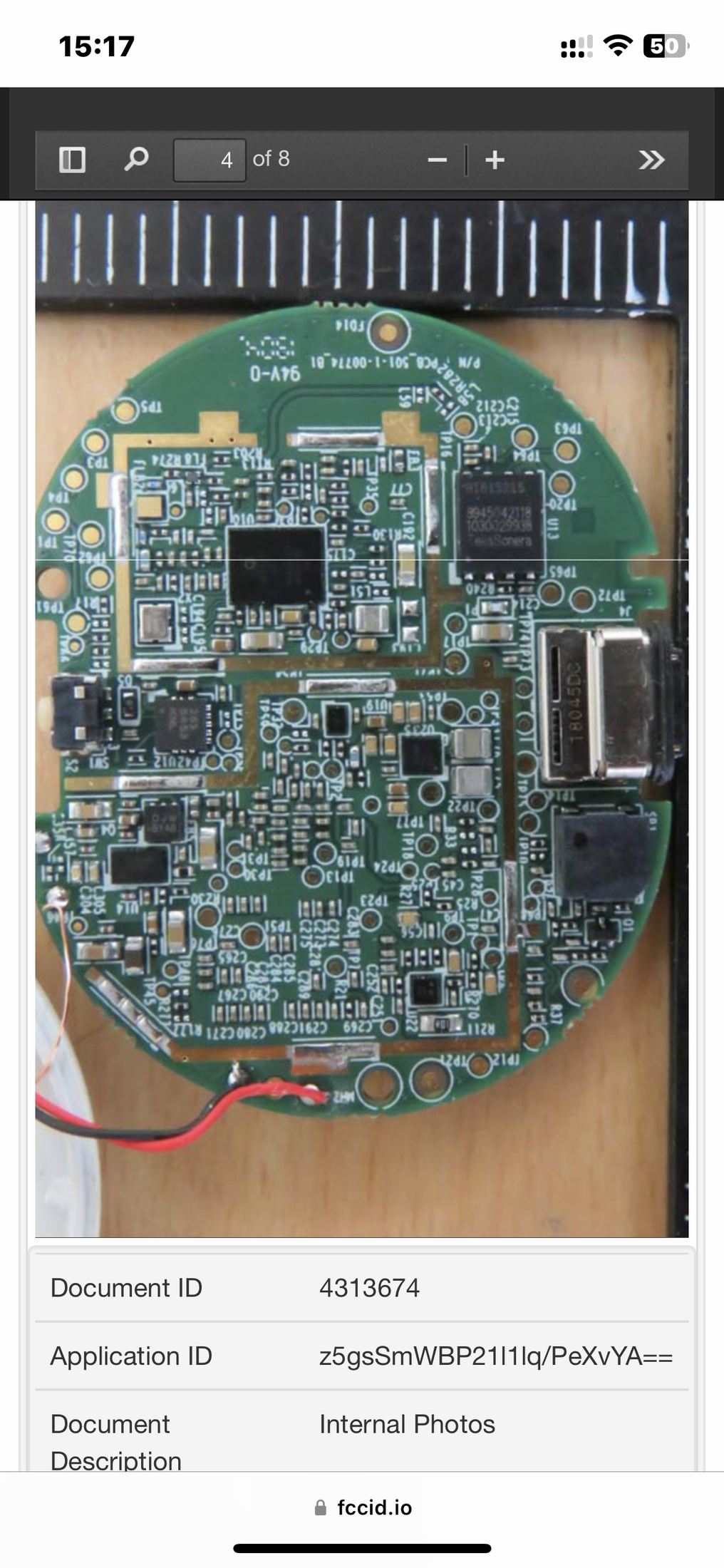

Chirita 0 #8 March 15, 2023 Photos from fccid Quote Share this post Link to post Share on other sites
sfzombie13 324 #9 March 16, 2023 i don't see a jtag connection but it looks like you could reprogram it if you knew how. you'd need some way to attach to the chip. some of those test points may also be the jtag and it just isn't labelled, some companies do it that way. i'm gonna look it up since i now have numbers to put into search engines. thanx for the pics. Quote Share this post Link to post Share on other sites
olofscience 495 #10 March 16, 2023 5 hours ago, sfzombie13 said: i don't see a jtag connection but it looks like you could reprogram it if you knew how. you'd need some way to attach to the chip. some of those test points may also be the jtag and it just isn't labelled, some companies do it that way. i'm gonna look it up since i now have numbers to put into search engines. thanx for the pics. That's a Qualcomm chip there - could be the main chip, or at least the cellular modem. You'd need a few million dollars and some pretty stringent NDAs to get any documentation from Qualcomm on how to program it... 1 Quote Share this post Link to post Share on other sites
sfzombie13 324 #11 March 16, 2023 Just now, olofscience said: That's a Qualcomm chip there - could be the main chip, or at least the cellular modem. You'd need a few million dollars and some pretty stringent NDAs to get any documentation from Qualcomm on how to program it... that's not what you need to program, the os or whatever runs it is what needs programmed. qualcomm has pretty good documentation on their chips and what the pins do, but they look real hard to get to the way they soldered the chip on the board. but it's hard for me to tell a lot from a picture because it isn't my specialty, just something i know about. i've done it before on other devices and could probably figure it out but maybe not. now going into the qualcomm firmware, you're right, no way to do that i could ever figure out anyway. Quote Share this post Link to post Share on other sites
Chirita 0 #12 March 17, 2023 Can this one be also fixed with a network provider since the sim is embedded on the motherboard ? Like giving them the IMEI number to activate it on their network! It uses a M2M-SIM-OnBoard (MFF2 size standard), cannot be changed by the user Quote Share this post Link to post Share on other sites

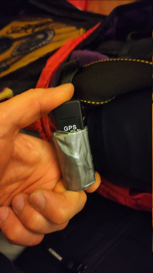

the.Legend 55 #17 November 1, 2023 (edited) I don't think many would focus on Yepzon because it's a bit of too much effort. I don't see UART pins on the board, so probably it's all via JTAG (i.e. USB) which is a bit more complex Thus the only reason to hack into this device for I see would be as a personal challenge, because there are few alternatives that require significantly less effort and skills: * No-brainer - sew an AirTag into your freebag * GPS tracker from AliExpress ( additionally you may install own opensource GPS tracking server like OpenGTS) You can then 3D print a custom pilot chute handle to serve as casing for the device https://www.aliexpress.com/item/1005006032717925.html folks from Empuria brava already doing something similar:https://empuriabravarigging.com/gps-handle/ * Build your own device: https://www.instructables.com/Homemade-Realtime-GPS-Tracker-SIM800L-Ublox-NEO-6M/ use Seeeduino or Adafruit Trinket to save space List is sorted in ascending order by skills & effort required UPD: I just ordered one from China, will do its review keep you posted Edited November 1, 2023 by the.Legend Quote Share this post Link to post Share on other sites

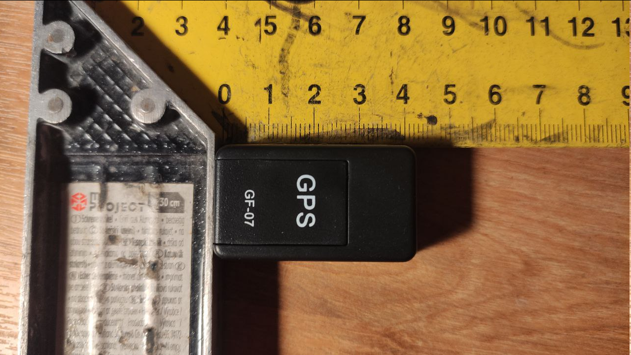

the.Legend 55 #22 December 21, 2023 So my tracker from AliExpress has finally arrived. Size-wise it looks good - nearly perfect fit for SkySnatch's pipe handle But turns out this is not a GPS, rather GPRS tracker, just like this review says:https://www.youtube.com/watch?v=FsMKcn3R2tQ (I wish I've seen it sooner) Checked its insides and indeed there's no GPS hardware. Technically you may use it along with call capabilities - i.e. look for a canopy by making noise and listening how close you get to the point, but IMHO its not worth the effort of installing it. Will search for something similar, but with real GPS capabilities Quote Share this post Link to post Share on other sites
