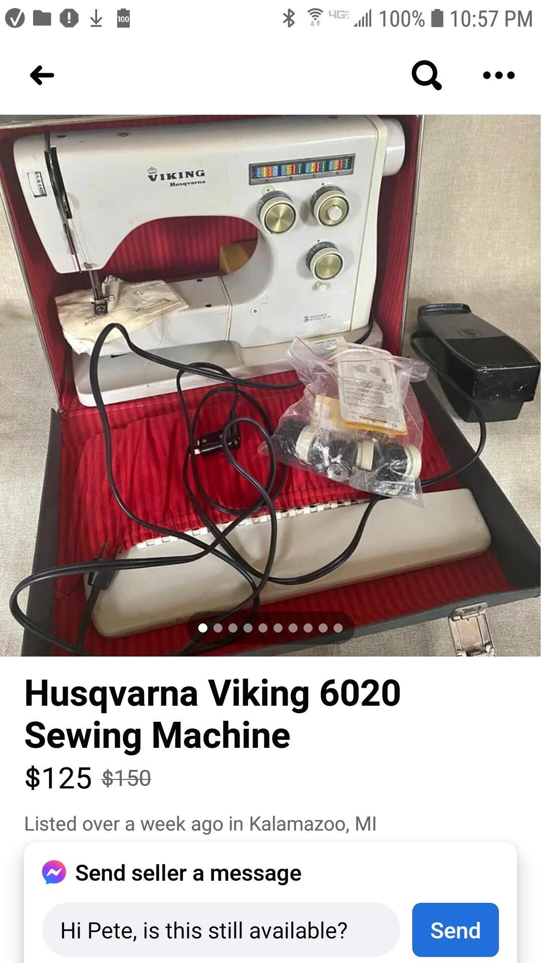

councilman24 37 #7 April 4, 2023 For a long time I didn't have an industrial machine. Now I have 63 industrial heads including these zig zag machines. 2 Pfaff 238's, 5 Singer 20u's, 2 Consew 199's, Bernina 217, 3 Bernona 217n's, a Sing 17w15 (highest foot lift) and an sailrite LSZ-1 (that I haven't used). But first I had a Husqvarna Viking like the one in the photo but without all the fancy stitches. It STILL does zig zag on toggle noses better than any of the other zig zag machines. 6 layers of 1000lb type 4. If you can find one like this I'd grab it. Be aware a bartack is a specific pattern that includes straight and zig zag stitches. Various numbers if each stitch, sizes x and y, and starting and ending stitches. Quote Share this post Link to post Share on other sites
