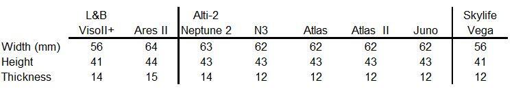

sundevil777 102 #6 January 2, 2023 Here is a comparison of dimensions, rounded to whole mm. I'm interested in the Skylife products so the Vega which seems like a bargain is included: Quote Share this post Link to post Share on other sites
