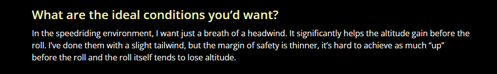

SethInMI 174 #6 December 6, 2022 (edited) I noticed this comment from Jesse: Why does a headwind vs tailwind matter for the roll performance? I can understand if he is talking about a change in wind speed during descent / a bit of wind shear? or that somehow near the ground there is some interaction with the surface that affects the wind just above it? otherwise the only reason a headwind would be preferred would be to slow down the landing runout right? Edited December 6, 2022 by SethInMI typo Quote Share this post Link to post Share on other sites
pchapman 281 #7 December 6, 2022 1 hour ago, SethInMI said: Why does a headwind vs tailwind matter for the roll performance? I can understand if he is talking about a change in wind speed during descent / a bit of wind shear? Yeah I'm guessing it is the normal wind shear that exists near the surface, with wind speed sometimes significantly increasing in the bottom 100' or whatever of the atmosphere. I'm not totally sure of the logic in all cases. Eg, why do you want just a little headwind, rather than a moderate although still smooth headwind being equally as good? But anyway, if you are down low with lets say near zero wind and pop up into a higher headwind, wham, you can get a temporary boost in lift, that gives you more margin before sinking out back to ground level. ("Temporary" until inertia effects and aerodynamics have you and the canopy reacting to the changed wind conditions.) (Note that the upwards trajectory in the maneuver matters too as the increased headwind also increases the angle of attack, also boosting lift. In contrast, when on a normal skydive you are just descending on a normal glide under a parachute, and suddenly you get a headwind, yes the wind speed hitting the canopy is higher, but the angle of attack of the canopy will suddenly be lower -- so depending on angles and speeds, the combination of greater speed but less angle of attack may give more or less lift -- the canopy might sink faster rather than sinking less fast, or even have the nose collapse downwards if the angle of attack got too low. ) Quote Share this post Link to post Share on other sites
ChrisHoward 8 #8 April 28, 2023 (edited) On 12/6/2022 at 2:53 PM, SethInMI said: I noticed this comment from Jesse: Why does a headwind vs tailwind matter for the roll performance? I can understand if he is talking about a change in wind speed during descent / a bit of wind shear? or that somehow near the ground there is some interaction with the surface that affects the wind just above it? otherwise the only reason a headwind would be preferred would be to slow down the landing runout right? I'm with you. In the sense that the head wind vs tail wind will affect perspective and not actual performance of the wing in its given envelope of air. Edited April 28, 2023 by ChrisHoward Edit: Didn't watch read the article. Quote Share this post Link to post Share on other sites
