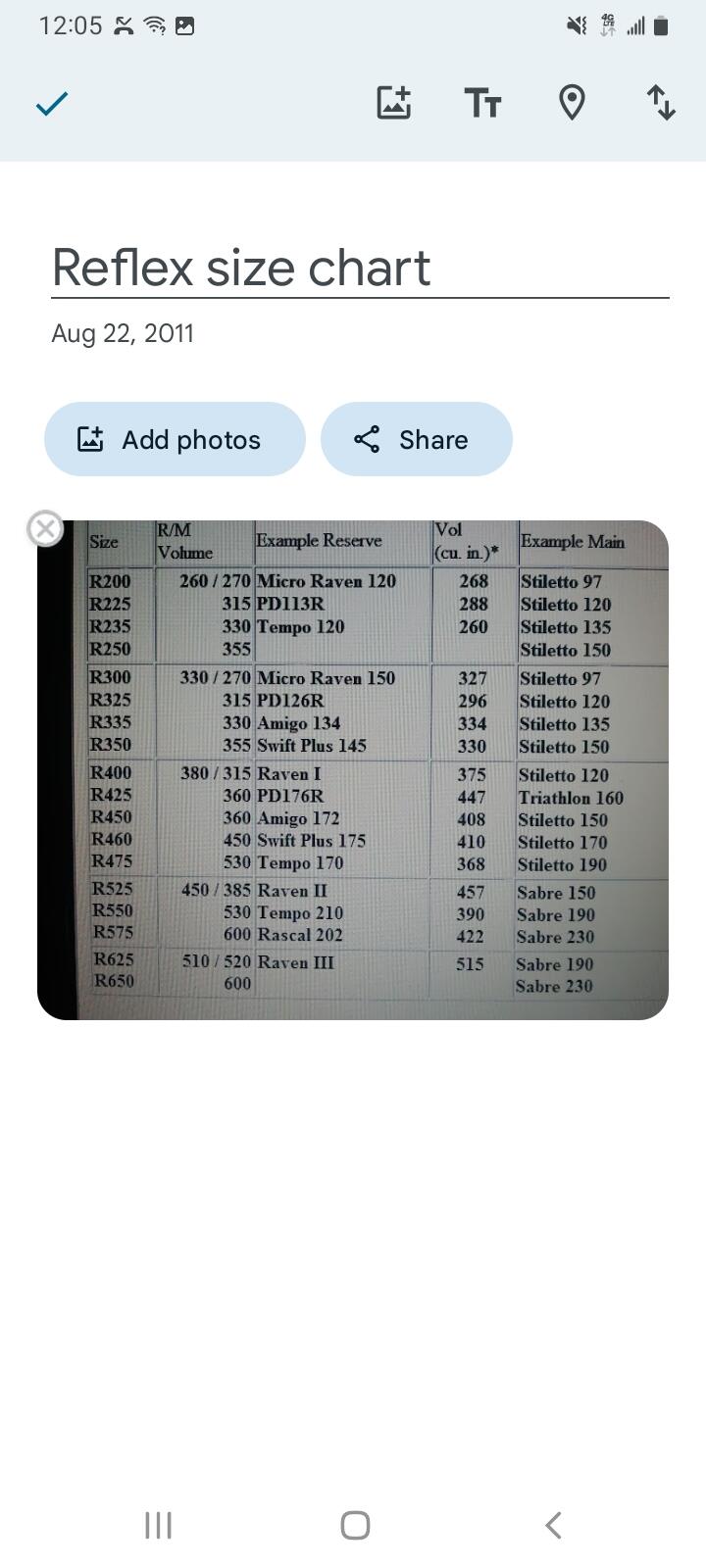

ronaldheadrick 0 #1 Posted November 3, 2022 (edited) yes i have a reflex container the tray size i have found says it is a r460 i have a raven 181 reserve how big of a main will fit with the 181 raven reserve will a triathlon 210 fit ok i know i can get it in there but is it ok the tso on the container is c23d Edited November 3, 2022 by ronaldheadrick added more info Quote Share this post Link to post Share on other sites
riggerrob 643 #2 November 3, 2022 Did you look at the Reflex manual? Quote Share this post Link to post Share on other sites

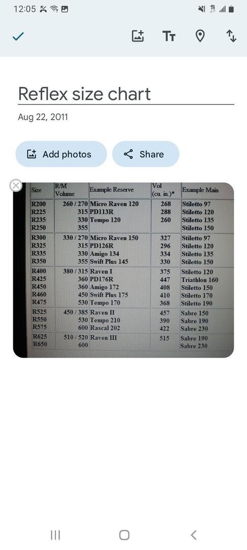

riggermick 7 #3 November 9, 2022 410 cubic inches, stillletto 170, main pack tray Mick. Quote Share this post Link to post Share on other sites
kleggo 145 #4 November 9, 2022 16 minutes ago, riggermick said: 410 cubic inches, stillletto 170, main pack tray Mick. from the fingers of the Cflex / Reflex designer / builder / manufacturer Quote Share this post Link to post Share on other sites
riggermick 7 #5 November 9, 2022 31 minutes ago, riggermick said: 410 cubic inches, stillletto 170, main pack tray Mick. Share this Quote Share this post Link to post Share on other sites
JWilt73 0 #6 January 13, 2023 I have a R475, also with a Raven -M 181. I it will hold up to a 210 sabre or pilot but is fairly tight but acceptable. When built, it was ordered for a 190 Sabre 2. riggerMick, if you're watching what do you recommend for parts such as PC and stuff since can't hardly find reflex parts? I bought mine new in 2000 and still love it. Never had an issue other than me getting larger. Quote Share this post Link to post Share on other sites
