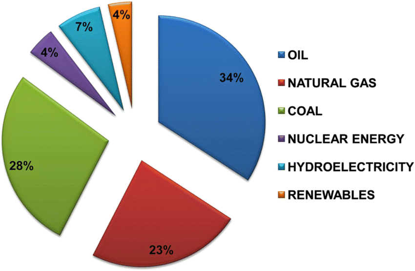

brenthutch 444 #10 October 26, 2022 56 minutes ago, Phil1111 said: The past decade has seen more than 50 US coal companies fall into bankruptcy and over 100 gigawatts (GW) of coal capacity either retired or slated for closure. Over the past seven years,(to 2021) "there have been 274 oil and gas producer bankruptcies. In the same period, 330 oilfield services and midstream companies have filed for bankruptcy, bringing the combined North American industry total to more than 600 industry bankruptcies involving over $321 billion in secured and unsecured debt. "That is about a third of a trillion for those with a MBA. Why does Brent always pick the worst performing option? I pick the winning option Quote Share this post Link to post Share on other sites
lippy 918 #11 October 26, 2022 1 hour ago, brenthutch said: I pick the winning option Classic Brent….random chart posted, mike dropped 2 Quote Share this post Link to post Share on other sites
JoeWeber 3,023 #12 October 26, 2022 48 minutes ago, lippy said: Classic Brent….random chart posted, mike dropped Pretty easy to read, though. Quote Share this post Link to post Share on other sites
lippy 918 #13 October 26, 2022 3 minutes ago, JoeWeber said: Pretty easy to read, though. The chart….or Brent? Quote Share this post Link to post Share on other sites
