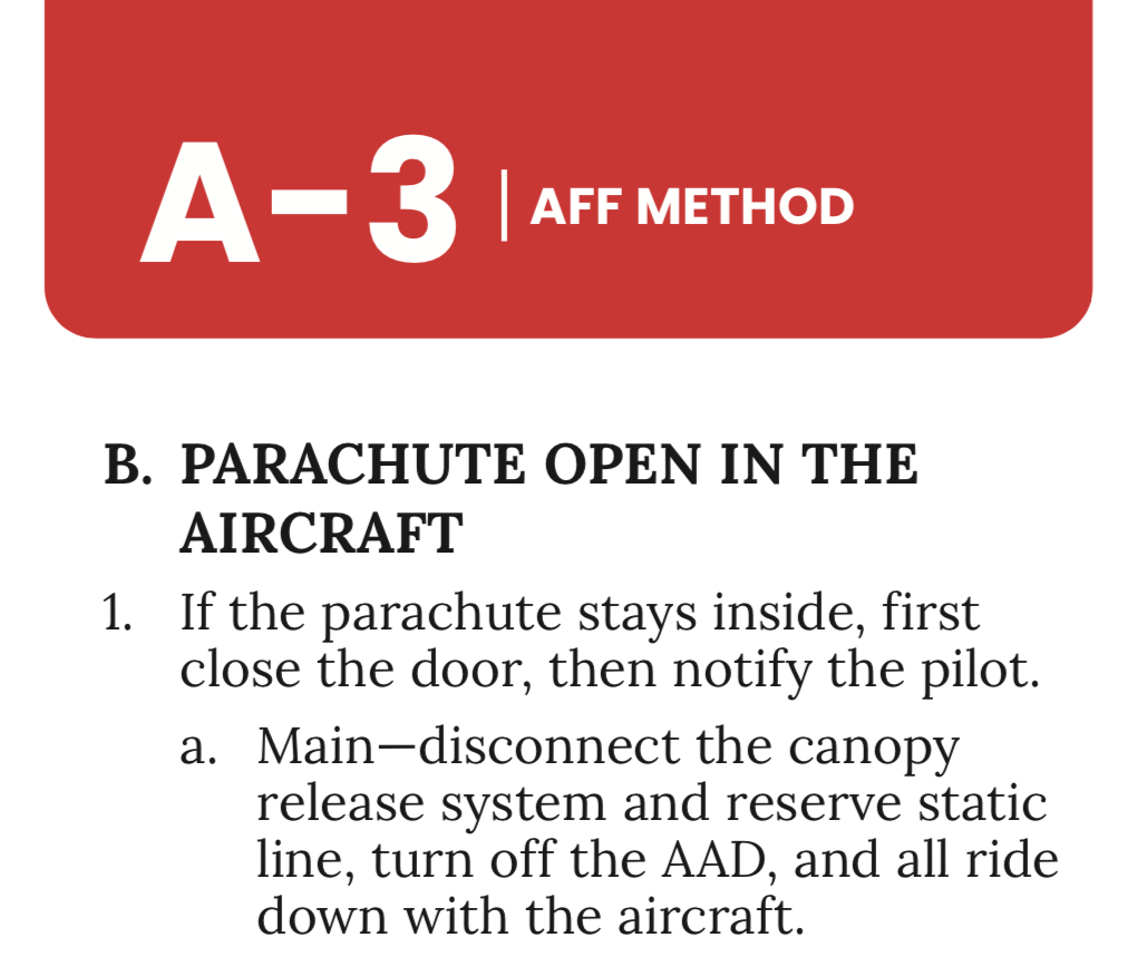

kmzamani 2 #1 Posted September 26, 2022 Based on IRM , if parachute opens in Aircraft it must be disconected , ADD off and all ride down with the aircraft . please clarify that it means all the jumper in board should ride down with the aircraft or just the jumper who his /her parachute open ? Quote Share this post Link to post Share on other sites
anomie168 16 #2 September 26, 2022 (edited) If someone reopens the aircraft door and I am in the aircraft with a loose canopy or pilot chute, I'm going to lose my damn mind. "and all ride down with the aircraft" Edited September 26, 2022 by anomie168 highlight a statement 3 Quote Share this post Link to post Share on other sites
riggerrob 644 #3 September 26, 2022 If a parachute is even partly open in the plane, it creates a HUGE risk of inflating immediately outside the door and ripping the tail off of the airplane. That is why we keep the door closed. I have seen a few attempts at re-closing rigs in the airplane. Most were successful from a rigging point-of-view, but the user was too rattled to pull the correct handles in the correct sequence. 1 Quote Share this post Link to post Share on other sites
wolfriverjoe 1,523 #4 September 27, 2022 Everyone rides down. Opening the door with a loose pilot chute, main or reserve canopy is REALLY stupid. 1 Quote Share this post Link to post Share on other sites
pchapman 280 #5 September 27, 2022 Everyone ride down? Huh, interesting. Not the way I've seen it done a couple times over the decades. Just contain it out of the way and others jump. Although admittedly if others jump, that is a bit of a, "Screw you you dumbass, you can sit there white-knuckle clutching your damn parachute, we're going jumping like we planned" move.... Or in more detail, keep door closed, contain the parachute, shuffle the guy to the front of the Caravan for example (far from the door), then the guy stays in the plane (plus an instructor if he's a student), others jump. It's not hard to hold on to or sit up against a spring loaded PC or a bagged main, holding it against a wall or bulkhead. Or if it is a C-182, get him to the back corner and the rest could jump. Although there can be variations depending on experience levels, like deciding it is safer just to descend with the full load in the 182, because it is cramped or moving a scared student could be tricky or whatever. Sure one is assuming someone else isn't going to take the tail off on that very same jump run and leave the unfortunate jumper with an even crappier than usual situation! But certainly everyone riding down is a valid thing to do. 2 Quote Share this post Link to post Share on other sites
Baksteen 84 #6 October 5, 2022 In a large aircraft I might -just might- overlook people jumping if the open parachute is contained far away from the door by more than one person. In a small aircraft like a 182 or 172 not so much. IMO the risk of fabric escaping containment and inflating is much larger. You'd get at least a talking to. I'm no S&TA, but if you'd close your container and jump, I guess you'd get your ass grounded. But then again, I've always been known as a cautious jumper. 1 Quote Share this post Link to post Share on other sites
base615 77 #7 October 6, 2022 Seen it happen a couple of times in large aircraft and both times the jumper went to the front and everyone got out after a go-around. Honestly, it doesn't present too much of a risk in a Caravan / Otter, etc. but you obviously couldn't consider that in a small Cessna. Quote Share this post Link to post Share on other sites
RolandForbes 44 #8 October 10, 2022 (edited) Saw this happen at like 2k in the DC-3 at Eloy. Fuckin dood took his rig off and repacked it in the aisle. I shit you not, a true cowboy Edited October 10, 2022 by RolandForbes Quote Share this post Link to post Share on other sites
wolfriverjoe 1,523 #9 October 10, 2022 47 minutes ago, RolandForbes said: Saw this happen at like 2k in the DC-3 at Eloy. Fuckin dood took his rig off and repacked it in the aisle. I shit you not, a true cowboy If it's just a matter of reclosing the main container and restowin the pilot chute, I'd be mostly ok with that. In a DC-3, you have plenty of time. There wouldn't be any rush to close it fast. 1 Quote Share this post Link to post Share on other sites
wmw999 2,621 #10 October 10, 2022 In a DC3, it might have been long enough ago to have been a spring-loaded pilot chute. A little more sporty, that. Wendy P. 2 Quote Share this post Link to post Share on other sites
hodges 4 #11 October 17, 2022 (edited) We don't turn off the AAD on our student rigs - we just tell the pilot to descend slow enough. I don't see the point of chopping the main. It just creates opportunity for someone to forget about the RSL and deploy their reserve accidentally. Main thing is that it doesn't go out of the door! Edit: I suppose an aircraft emergency could develop and it'd be easier to get out not holding your main in your hands. If you're ever in freefall holding your d-bag, you're having a bad day... Edited October 17, 2022 by hodges 2 Quote Share this post Link to post Share on other sites
