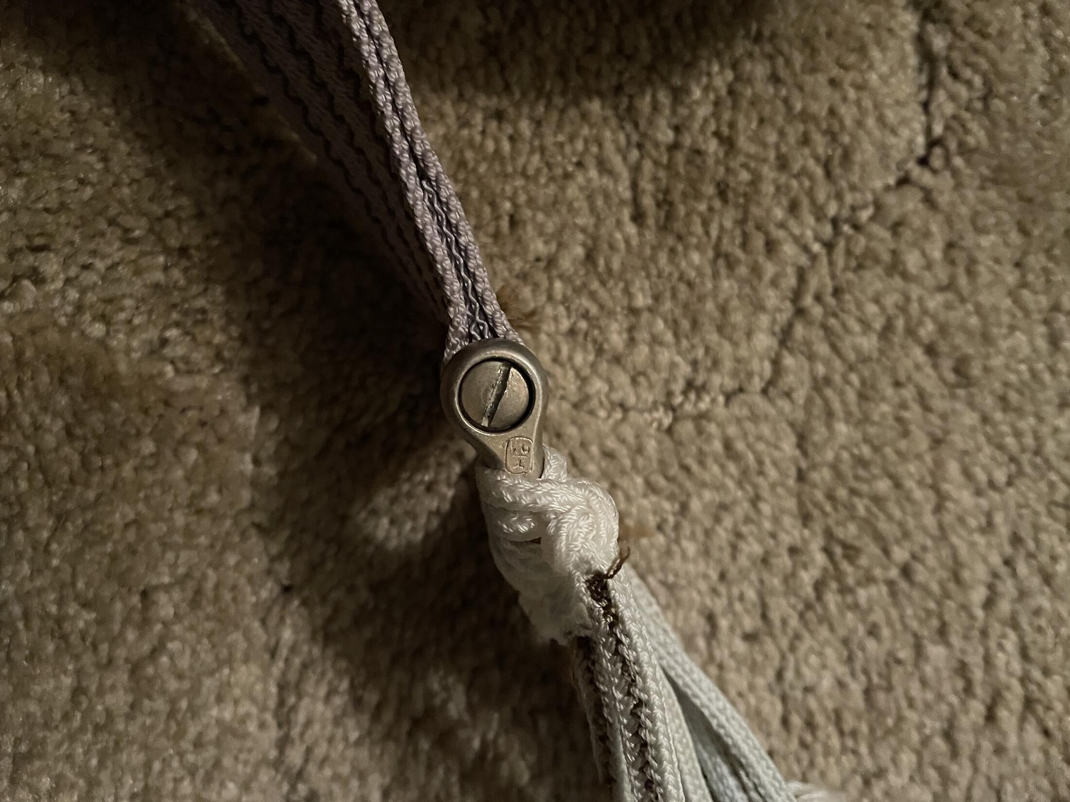

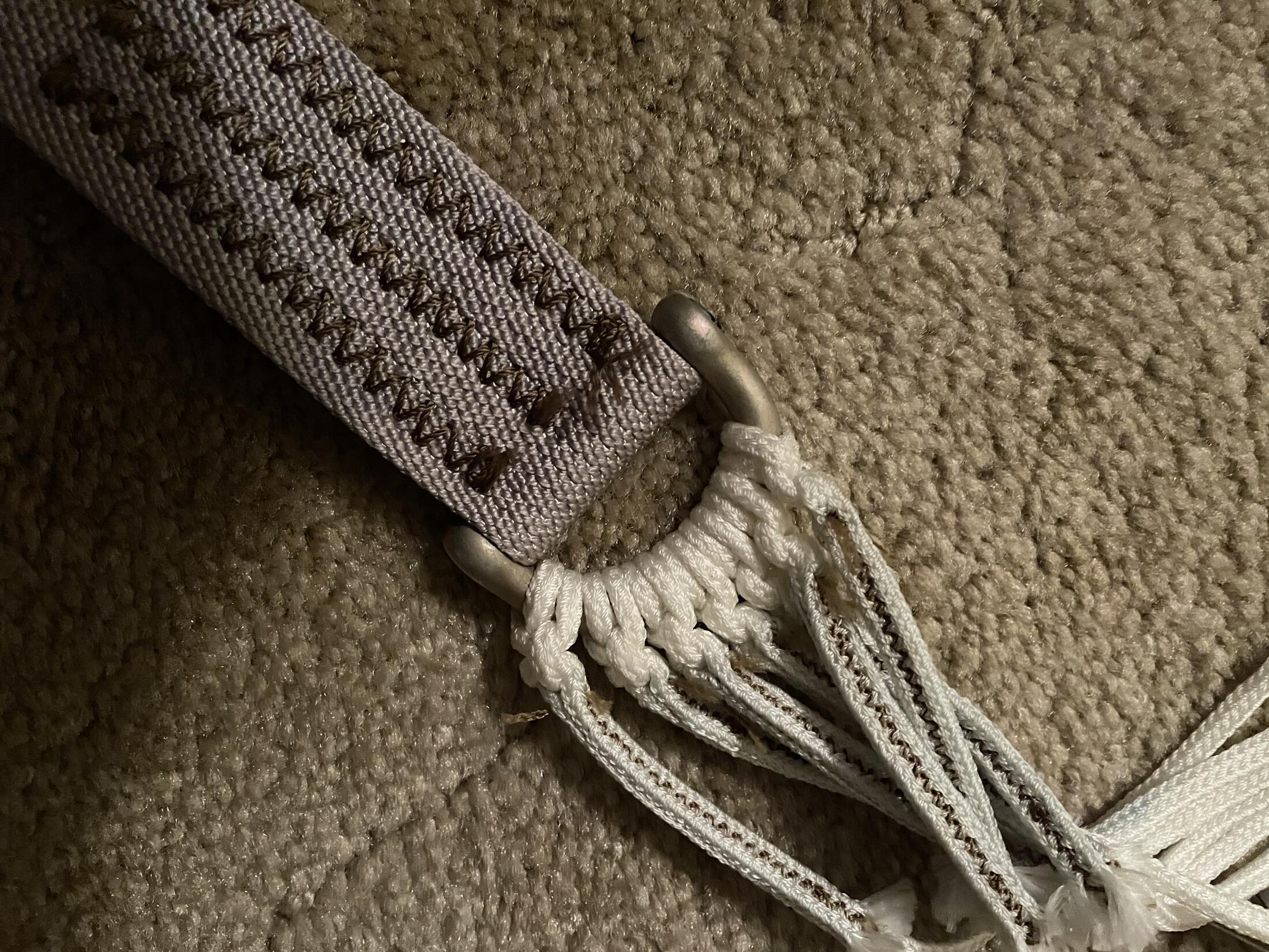

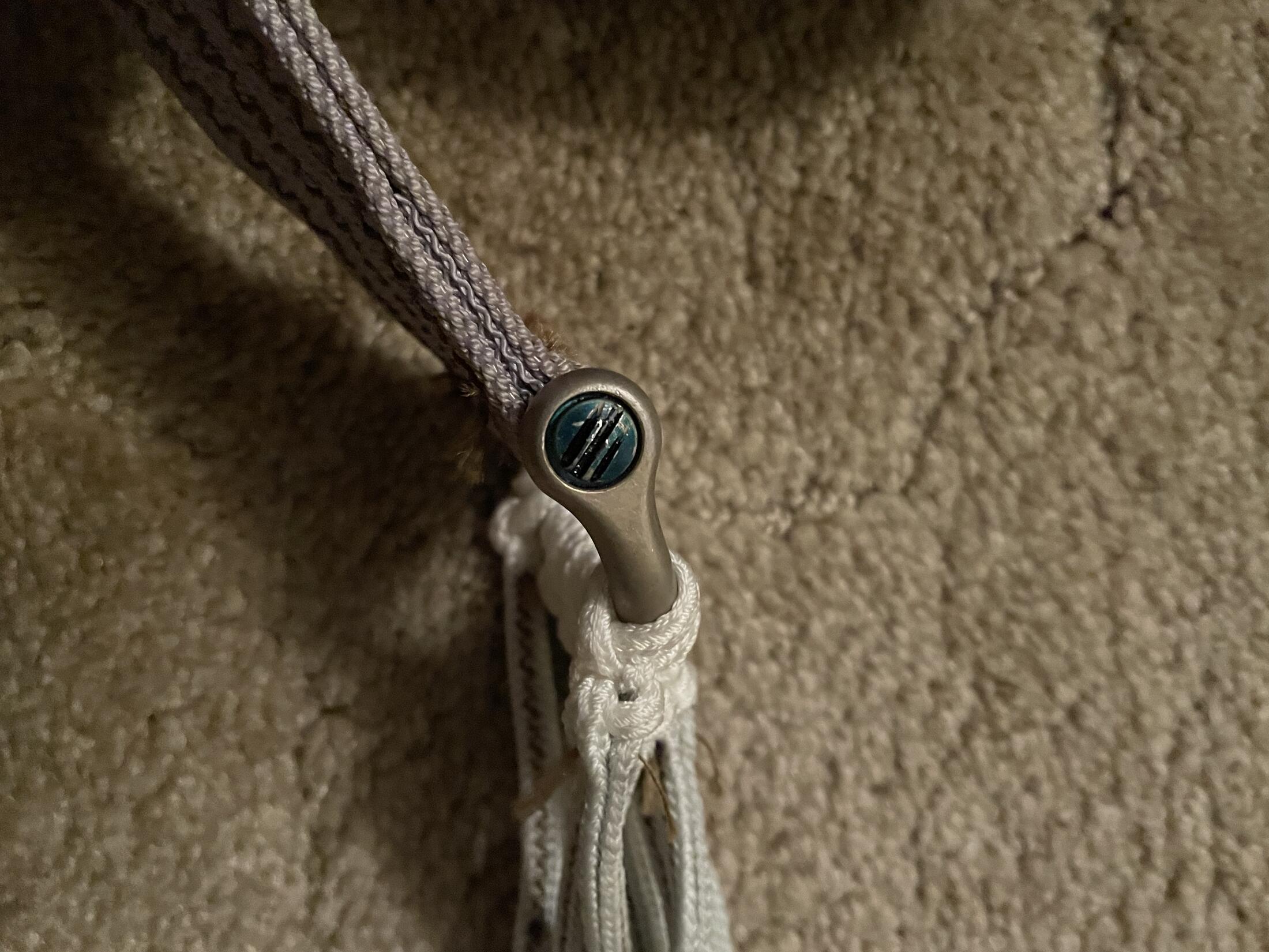

wfadams 1 #1 Posted September 7, 2022 Does anyone know how to remove the screw/bolt from the D-Ring so I can detach the parachute lanyards? I tried to turn the screw with a screw driver both ways but in just a little of a turn it gets tight and does not seem to loosen up. Please Help!!!!!!!!!!!!!! 1 Quote Share this post Link to post Share on other sites

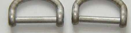

Veis 29 #2 September 7, 2022 Hi, both have threads. The hairpin is right, and the counter screw is left, as i remember. I hope this is not recognized as a military secret) 1 Quote Share this post Link to post Share on other sites
wfadams 1 #3 September 7, 2022 8 hours ago, Veis said: Hi, both have threads. The hairpin is right, and the counter screw is left, as i remember. I hope this is not recognized as a military secret) Which one is the hair pin and which is the counter screw. Forgive my stupidity. Quote Share this post Link to post Share on other sites
Veis 29 #4 September 8, 2022 9 hours ago, wfadams said: Which one is the hair pin and which is the counter screw. Forgive my stupidity. there is a noticeable thin at the far end of the pin Quote Share this post Link to post Share on other sites
wfadams 1 #5 September 8, 2022 9 hours ago, Veis said: there is a noticeable thin at the far end of the pin Just to be clear. The hair pin is turned clockwise and the counter screw is turned counter clockwise? Quote Share this post Link to post Share on other sites
Veis 29 #6 September 8, 2022 2 hours ago, wfadams said: Just to be clear. The hair pin is turned clockwise and the counter screw is turned counter clockwise? The main pin is the usual right thread, the counter screw is left. You may have to use two screwdrivers and more hands to disassemble it. And vise, clamp etc... Quote Share this post Link to post Share on other sites
