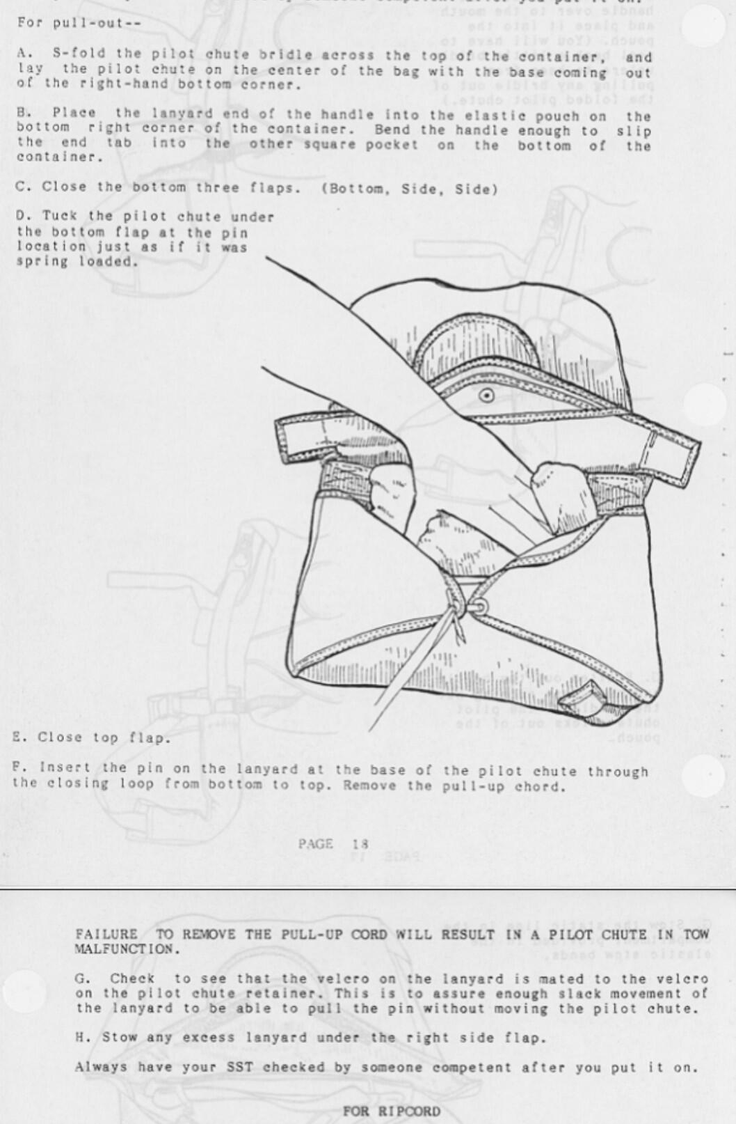

jmd 0 #1 Posted July 19, 2022 (edited) I can get that old thing into the container but have no idea what to do with the bridle routing or pilot chute stow and fold or where it goes ... can somebody direct to the file or give me info? I appreciate the input. Tnx! Edited July 19, 2022 by jmd Quote Share this post Link to post Share on other sites

riggerrob 644 #5 July 19, 2022 When packing pull-out pilot-chutes, the key is keeping most of the pilot-chute bulk in the lower right corner of the main container. That way, the first part of your pull only has to pull the pin. Then the second part of the pull extracts the pilot-chute. Kind of like a 2-stage trigger on a gun. Manuals from other manufacturers of pull-out containers: Javelin, Vector, etc. will provide good hints. Finally, take a close look at compatibility between the pull-out handle and the container. Flying High started with "fuzzy rat" all-Velcro handles, but eventually shifted to handles stiffened with a piece of plastic. Quote Share this post Link to post Share on other sites
dudeman17 364 #6 July 19, 2022 5 hours ago, riggerrob said: When packing pull-out pilot-chutes, the key is keeping most of the pilot-chute bulk in the lower right corner of the main container. Except that he said... 20 hours ago, jmd said: ...has aleft hand side direct pull deployment... ...which if that means what it sounds like, that the pull out is on the left side (which is odd and unusual but not unheard of), then the pilot chute bulk wants to be in the lower left corner? Quote Share this post Link to post Share on other sites

jmd 0 #10 July 21, 2022 On 7/19/2022 at 10:12 AM, riggerrob said: When packing pull-out pilot-chutes, the key is keeping most of the pilot-chute bulk in the lower right corner of the main container. That way, the first part of your pull only has to pull the pin. Then the second part of the pull extracts the pilot-chute. Kind of like a 2-stage trigger on a gun. Manuals from other manufacturers of pull-out containers: Javelin, Vector, etc. will provide good hints. Finally, take a close look at compatibility between the pull-out handle and the container. Flying High started with "fuzzy rat" all-Velcro handles, but eventually shifted to handles stiffened with a piece of plastic. Hey my friend! Long time! Have a racer here that has the pud ... I can get the shiterroo in the container but where does the pilot chute go and how is it folded? On No. one flap? under no. 2? Pie folds? Likely ... Where are you these days? PM me! J-M Quote Share this post Link to post Share on other sites

pchapman 280 #12 July 21, 2022 (edited) From an old manual if you are still unsure. Really, one can stuff the pilot chute in just about anywhere it fits on top of the bag. Mushroom it, or fold it neatly, whatever. Just has to be clear (not jammed in between the bag and container when it is open), and the base has to be near the corner with the pud, so the pud can pull the pin without having to move the pilot chute (so it doesn't jam when the container is closed). Something about not being pretty but it works. Not sure if it grandfathers you to pull at 2k. :-) I used to use a Racer with a pullout. Edited July 21, 2022 by pchapman 2 Quote Share this post Link to post Share on other sites
jmd 0 #13 July 22, 2022 5 hours ago, pchapman said: From an old manual if you are still unsure. Really, one can stuff the pilot chute in just about anywhere it fits on top of the bag. Mushroom it, or fold it neatly, whatever. Just has to be clear (not jammed in between the bag and container when it is open), and the base has to be near the corner with the pud, so the pud can pull the pin without having to move the pilot chute (so it doesn't jam when the container is closed). Something about not being pretty but it works. Not sure if it grandfathers you to pull at 2k. :-) I used to use a Racer with a pullout. There it is! really appreciate your time ... Blue Skies J-M Quote Share this post Link to post Share on other sites
