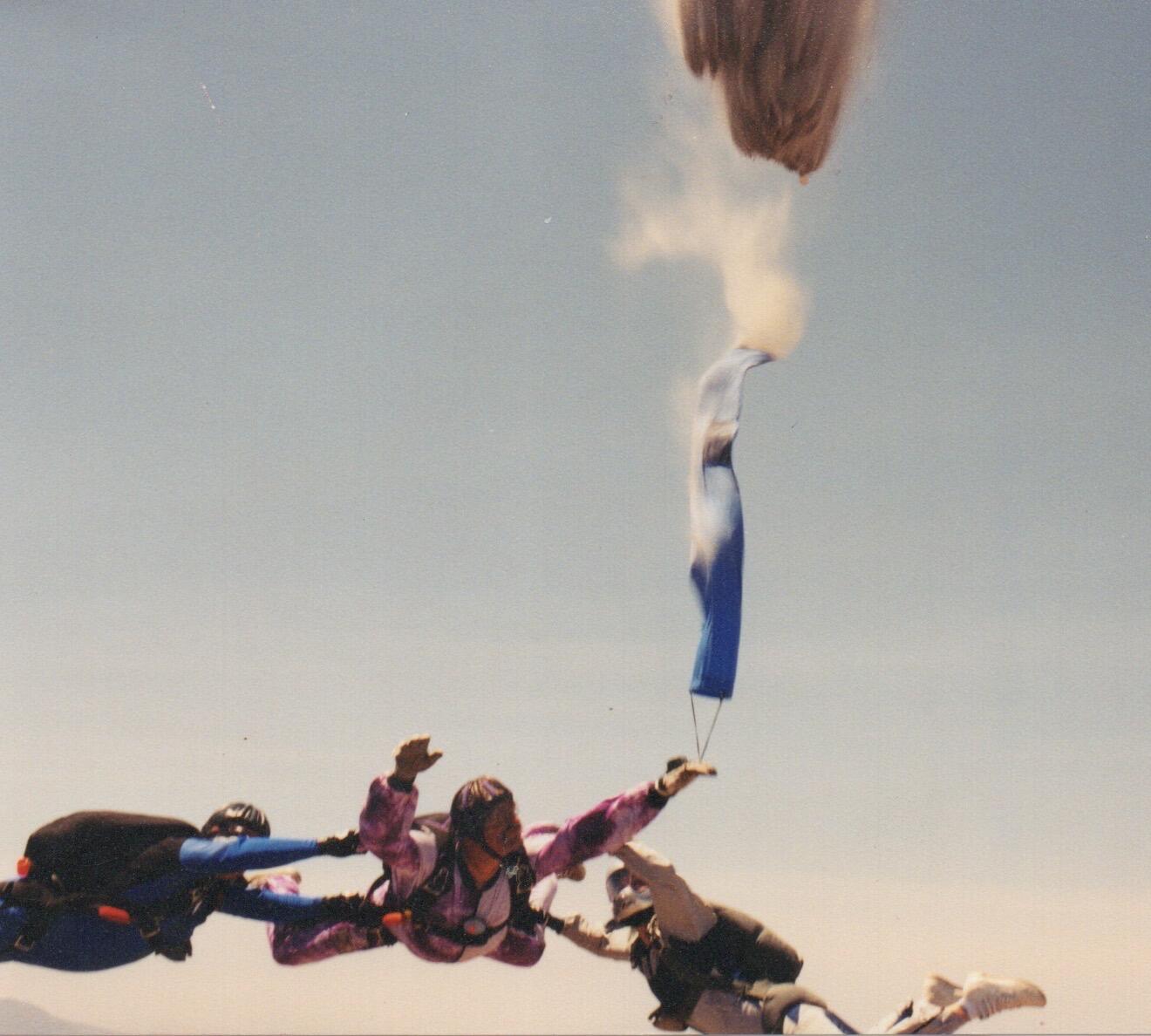

jimjumper 25 #3 June 2, 2022 (edited) This is Jerry Girdlers ash dive from a few years ago. The effect from the ground of the ashes is pretty impressive. I think I modified that tube from just the 2 lines to 3 to keep the opening of the tube more horizontal, although once air is in the tube those ashes are gone! Edited June 2, 2022 by jimjumper 1 Quote Share this post Link to post Share on other sites
IanHarrop 42 #4 June 2, 2022 Much thanks for this. The fact that the people on the ground know when the ashes go is a big plus. Now I just need a tube.... Does anyone have a good (easy) tube design? Quote Share this post Link to post Share on other sites
