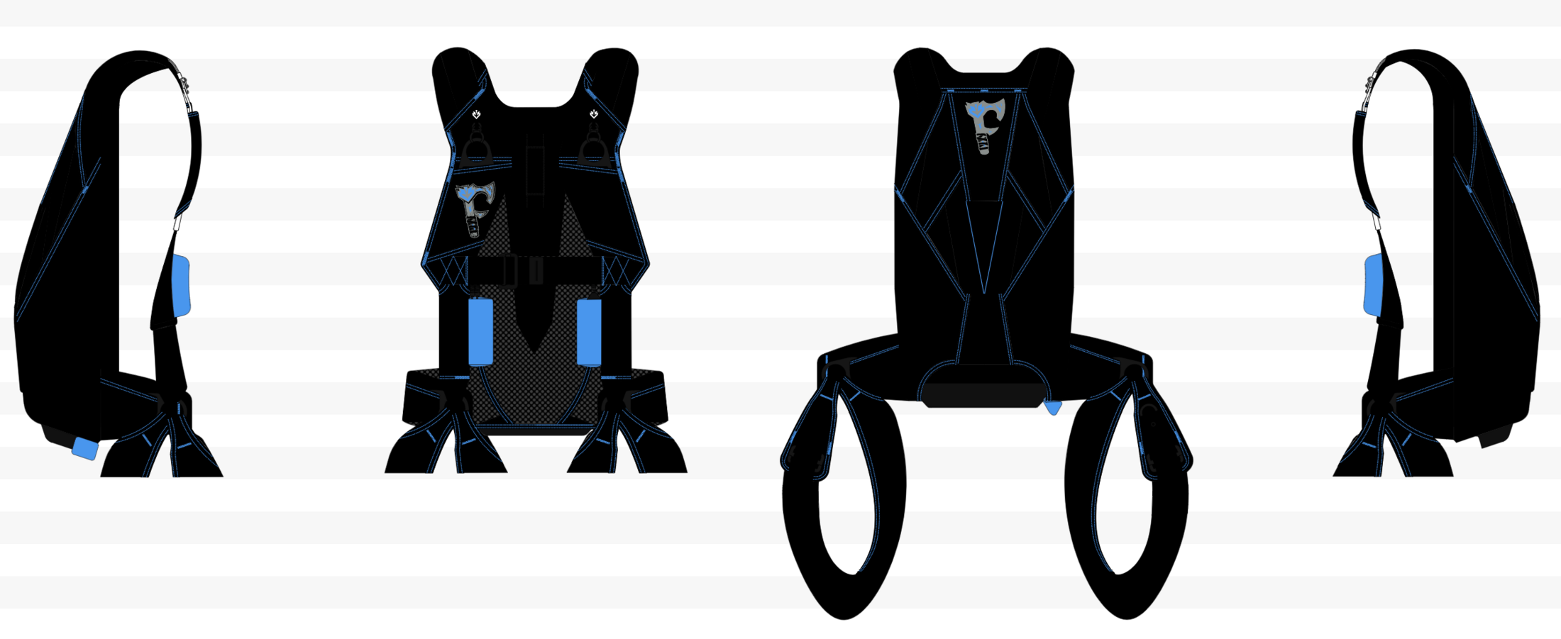

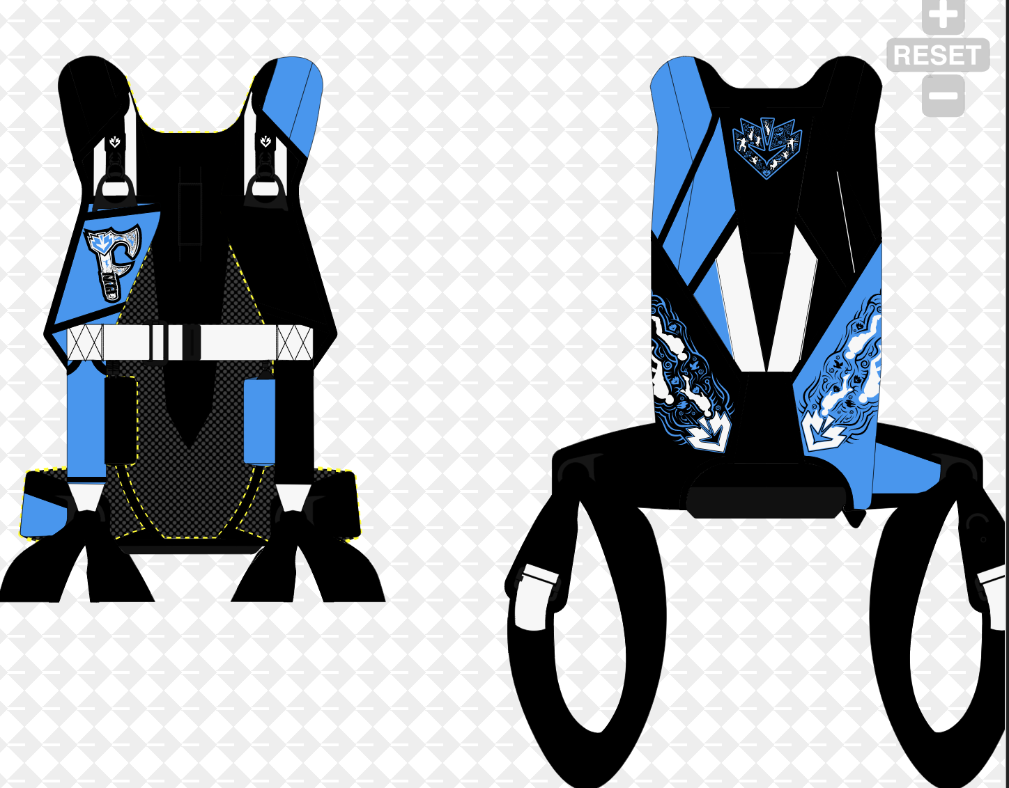

rjklein4470 23 #11 September 12, 2022 A couple of the designs I was working on Quote Share this post Link to post Share on other sites

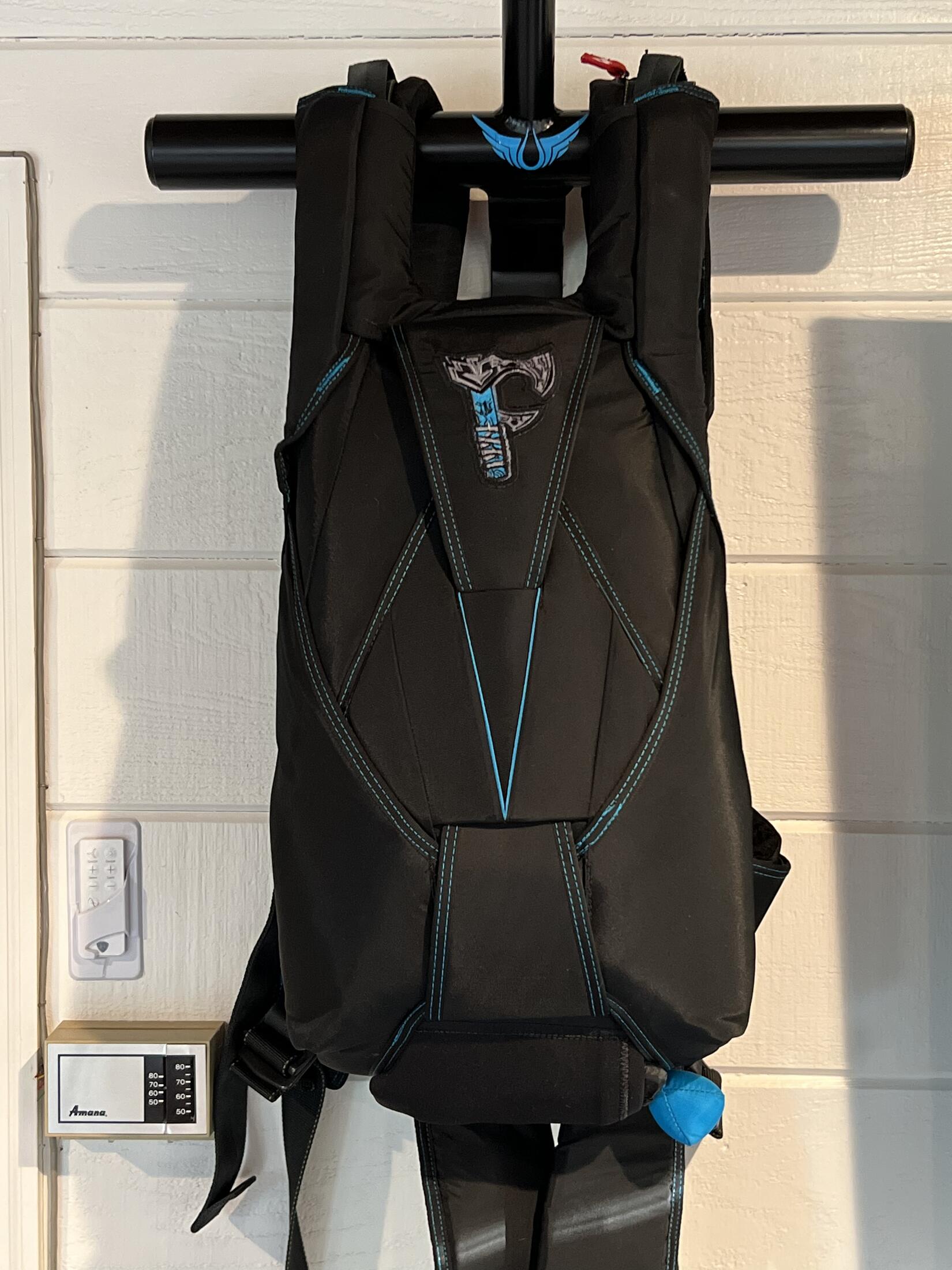

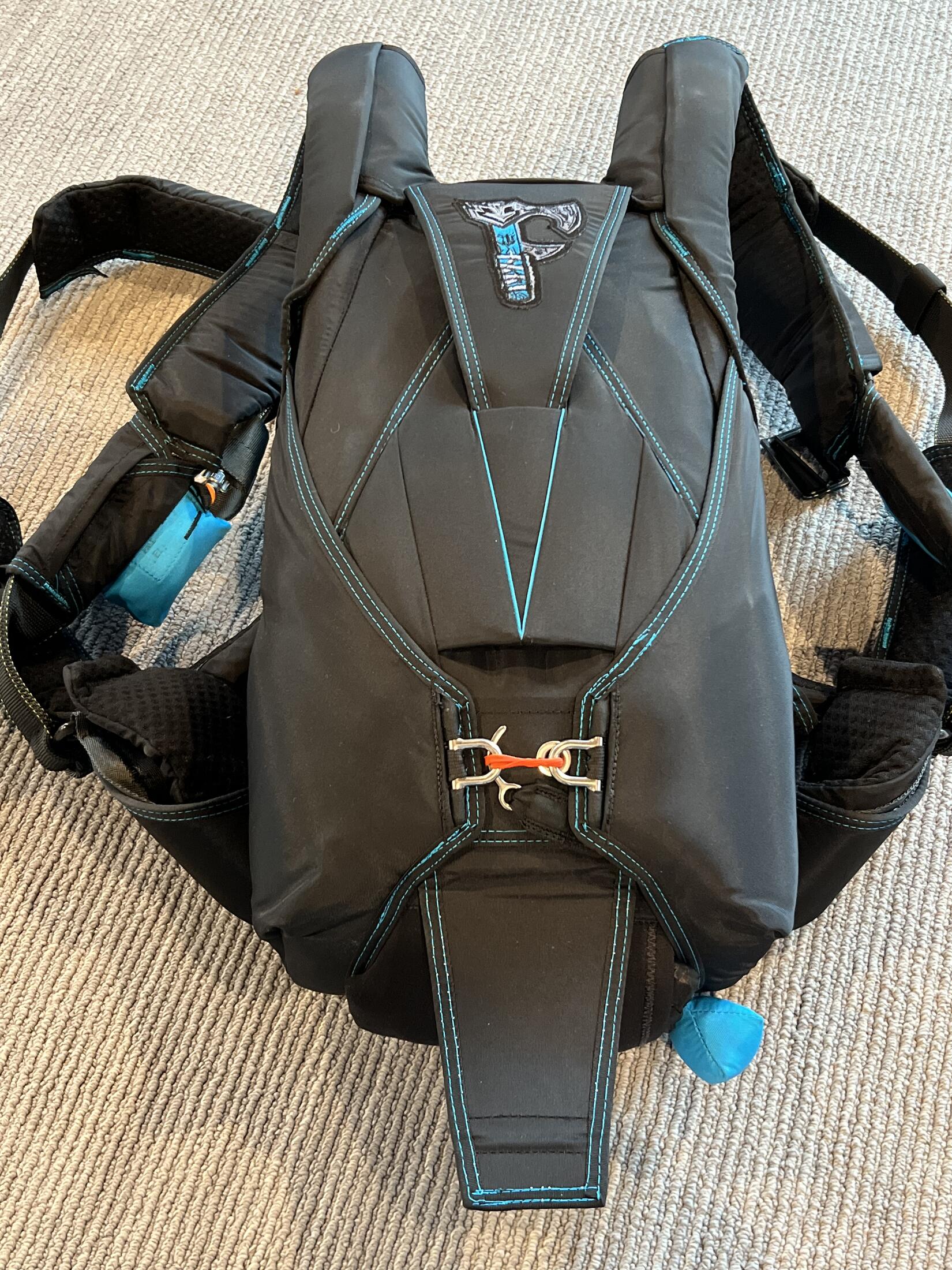

rjklein4470 23 #17 March 15, 2024 Couple pics of my rig. One of the best rigs I have ever owned. Quote Share this post Link to post Share on other sites
JerryBaumchen 1,445 #18 March 15, 2024 5 hours ago, rjklein4470 said: Couple pics of my rig. One of the best rigs I have ever owned. Hi 4470, Why do you have your RPC covered up? I believe that it supposed to be semi-exposed. Jerry Baumchen Quote Share this post Link to post Share on other sites
rjklein4470 23 #19 March 16, 2024 Not sure what you are talking about. These were the pictures I took before I jumped it. Dave’s riggers packed it at the factory. So can you be more specific? Quote Share this post Link to post Share on other sites
JerryBaumchen 1,445 #20 March 16, 2024 3 hours ago, rjklein4470 said: Not sure what you are talking about. These were the pictures I took before I jumped it. Dave’s riggers packed it at the factory. So can you be more specific? Hi 4470, Re: I believe that it is supposed to be semi-exposed. I have to say: My mistake. All of Dave's earlier products use a semi-exposed RPC, such as Sunpath's Javelin; where Dave worked for many, many yrs before going on his own. Enjoy your rig & forget my Senior Moment. Jerry Baumchen Quote Share this post Link to post Share on other sites
pchapman 279 #21 March 16, 2024 I had a look at the manuals to familiarize myself with them. Basically in line with what Jerry is saying, - the earlier Peregrine Glide has a semi-exposed RPC - the newer Peregrine Falkyn had a covered RPC Quote Share this post Link to post Share on other sites
