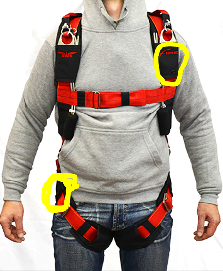

skydiverek 63 #2 March 28, 2022 (edited) These knives are great! Made of a SINGLE piece of steel (meaning, blade is NOT a seperate piece). Big one: Small one: I have both models. Bigger one under mud flap, smaller one under front leg strap cover (above the legstrap hardware). One high, one low. One on the right, one on the left. Just in case one of your arms is broken, or you cannot reach high or low in a canopy wrap. See below: Edited March 28, 2022 by skydiverek 1 Quote Share this post Link to post Share on other sites

councilman24 37 #14 July 14, 2022 (edited) This is the BIG one. On your sternum means you can get it with either hand and your sternum doesn't bend so knife never get in the way. Edited July 14, 2022 by councilman24 Quote Share this post Link to post Share on other sites
